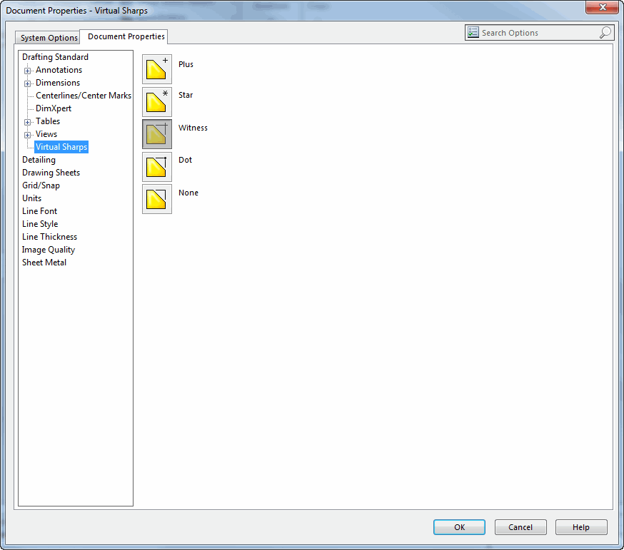

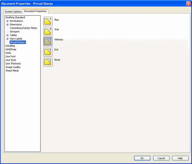

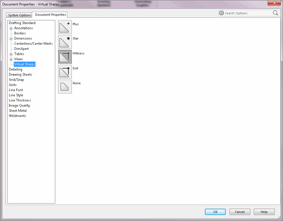

Document Properties > Virtual Sharps
Setting
Get/Set Methods
Return Value or <Value>
Comments
Virtual sharp style
IModelDocExtension::GetUserPreferenceInteger(swUserPreferenceIntegerValue_e.swDetailingVirtualSharpStyle, swUserPreferenceOption_e.swDetailingNoOptionSpecified)
IModelDocExtension::SetUserPreferenceInteger(swUserPreferenceIntegerValue_e.swDetailingVirtualSharpStyle, swUserPreferenceOption_e.swDetailingNoOptionSpecified, swDetailingVirtualSharp_e.<Value>)
See swDetailingVirtualSharp_e for valid options
Specifies display options for virtual sharps
