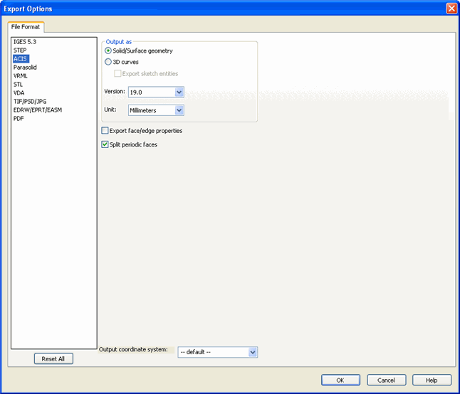

File > Save As > Save as type > ACIS > Options > ACIS
Setting
Get/Set Methods
Return Value
or
<Value>
or
<OnFlag>
Comment
Output as - Solid/Surface geometry
ISldWorks::GetUserPreferenceIntegerValue(swUserPreferenceIntegerValue_e.swAcisOutputGeometryPreference)
ISldWorks::SetUserPreferenceIntegerValue(swUserPreferenceIntegerValue_e.swAcisOutputGeometryPreference, swAcisOutputGeometryPreference_e.swAcisOutputAsSolidAndSurface)
Output as - 3D curves
ISldWorks::SetUserPreferenceIntegerValue(swUserPreferenceIntegerValue_e.swAcisOutputGeometryPreference, swAcisOutputGeometryPreference_e.swAcisOutputAs3DCurves)
Output as - Export sketch entities
ISldWorks::SetUserPreferenceIntegerValue(swUserPreferenceIntegerValue_e.swAcisOutputGeometryPreference, swAcisOutputGeometryPreference_e.swAcisOutputAs3DCurves_IncludeSketchEnts)
Output as - Version
ISldWorks::GetUserPreferenceIntegerValue(swUserPreferenceIntegerValue_e.swOutputVersion)
ISldWorks::SetUserPreferenceIntegerValue(swUserPreferenceIntegerValue_e.swOutputVersion, swACISOutputVersion_e.<Value>)
See swACISOutputVersion_e for valid options
Output as - Unit
ISldWorks::GetUserPreferenceIntegerValue(swUserPreferenceIntegerValue_e.swAcisOutputUnits)
ISldWorks::SetUserPreferenceIntegerValue(swUserPreferenceIntegerValue_e.swAcisOutputUnits, swLengthUnit_e.<Value>)
See swLengthUnit_e for valid options
Export face/edge properties
ISldWorks::GetUserPreferenceToggle(swUserPreferenceToggle_e.swSATExportFaceEdgeProps)
ISldWorks::SetUserPreferenceToggle(swUserPreferenceToggle_e.swSATExportFaceEdgeProps, <OnFlag>)
Boolean value
Specifies whether to export face and edge properties
Split periodic faces
ISldWorks::GetUserPreferenceToggle(swUserPreferenceToggle_e.swSATExportSplitPeriodic)
ISldWorks::SetUserPreferenceToggle(swUserPreferenceToggle_e.swSATExportSplitPeriodic, <OnFlag>)
Boolean value
Specifies whether to split periodic faces on export
Output coordinate system
IModelDocExtension::GetUserPreferenceString(swUserPreferenceString_e.swFileSaveAsCoordinateSystem, swUserPreferenceOption_e.swDetailingNoOptionSpecified)
IModelDocExtension::SetUserPreferenceString(swUserPreferenceString_e.swFileSaveAsCoordinateSystem, swUserPreferenceOption_e.swDetailingNoOptionSpecified, <Value>)
String value
Contains the name of the transform coordinate system; an empty string signifies that the  default coordinate system that does not require a transform; coordinate settings are not saved with the document; they must be selected at export time
