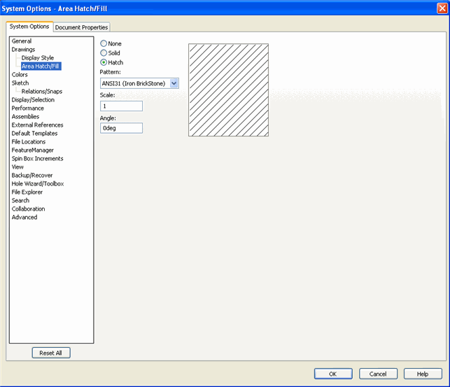

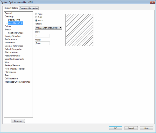

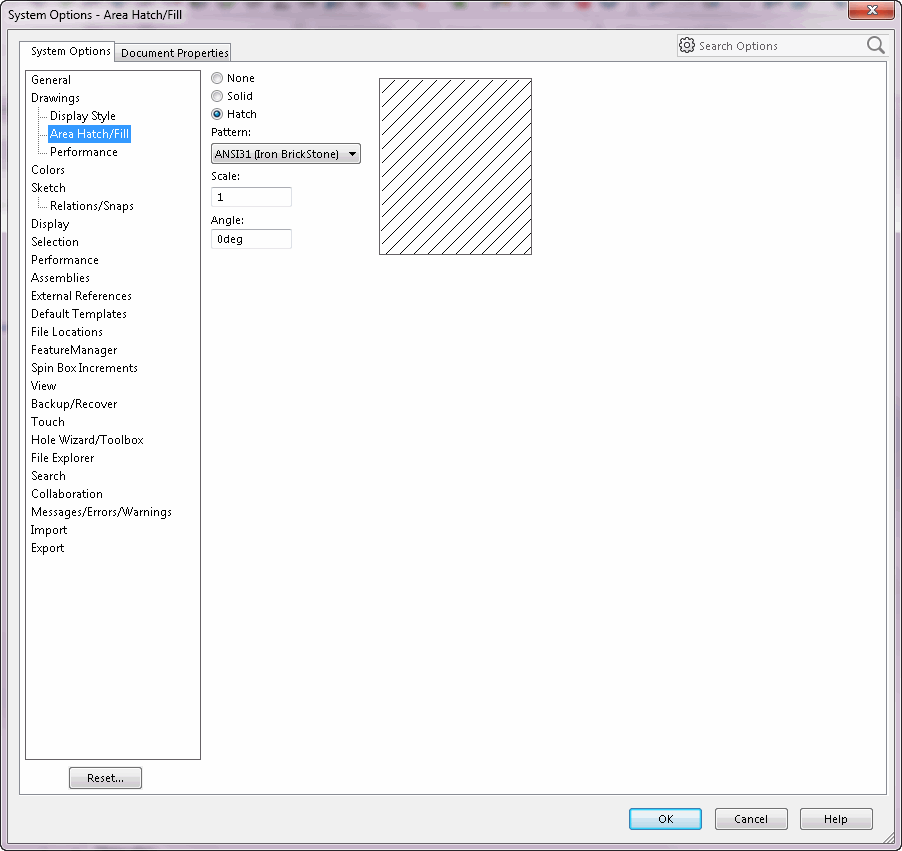

System Options > Drawings > Area Hatch/Fill
Setting
Get/Set Methods
Return Value
or
Value>
Comment
None
ISldWorks::GetUserPreferenceIntegerValue(swUserPreferenceIntegerValue_e.swDrawingAreaHatchFillStyle)
ISldWorks::SetUserPreferenceIntegerValue(swUserPreferenceIntegerValue_e.swDrawingAreaHatchFillStyle, swAreaHatchFillStyle_e.swAreaHatchFillStyle_None)
See swAreaHatchFillStyle_e for valid options
Solid
ISldWorks::SetUserPreferenceIntegerValue(swUserPreferenceIntegerValue_e.swDrawingAreaHatchFillStyle, swAreaHatchFillStyle_e.swAreaHatchFillStyle_Solid)
Hatch
ISldWorks::SetUserPreferenceIntegerValue(swUserPreferenceIntegerValue_e.swDrawingAreaHatchFillStyle, swAreaHatchFillStyle_e.swAreaHatchFillStyle_Pattern)

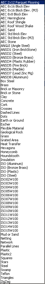

Pattern
ISldWorks::GetUserPreferenceStringValue(swUserPreferenceStringValue_e.swDrawingAreaHatchPattern)
ISldWorks::SetUserPreferenceStringValue(swUserPreferenceStringValue_e.swDrawingAreaHatchPattern, <Value>)
String value
Scale
ISldWorks::GetUserPreferenceDoubleValue(swUserPreferenceDoubleValue_e.swDrawingAreaHatchScale)
ISldWorks::SetUserPreferenceDoubleValue(swUserPreferenceDoubleValue_e.swDrawingAreaHatchScale, <Value>)
Double value
Specifies value to scale crosshatch
Angle
ISldWorks::GetUserPreferenceDoubleValue(swUserPreferenceDoubleValue_e.swDrawingAreaHatchAngle)
ISldWorks::SetUserPreferenceDoubleValue(swUserPreferenceDoubleValue_e.swDrawingAreaHatchAngle, <Value>)
Double value
Specifies angle for crosshatch
