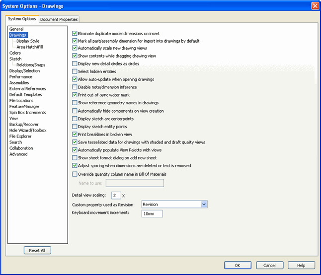

System Options > Drawings
This topic contains two tables. The information in the table:
  • appearing immediately after the screen capture of the System Options - Drawings dialog corresponds to the settings on that dialog.
  • titled Obsolete Enumerators contains enumerators that previously appeared on the System Options - Drawings dialog, but are now obsolete and no longer appear on that dialog.
Setting
Get/Set Methods
Return Value
or
<Value>
or
<OnFlag>
Comment
Eliminate duplicate model dimensions on insert
ISldWorks::GetUserPreferenceToggle(swUserPreferenceToggle_e.swDrawingEliminateDuplicateDimsOnInsert)
ISldWorks::SetUserPreferenceToggle(swUserPreferenceToggle_e.swDrawingEliminateDuplicateDimsOnInsert, <OnFlag>)
Boolean value
Specifies whether duplicate dimensions are eliminated when model dimensions inserted
Mark all part/assembly dimension for import into drawings by default
ISldWorks::GetUserPreferenceToggle(swUserPreferenceToggle_e.swDrawingMarkAllDimensionsForDrawing)
ISldWorks::SetUserPreferenceToggle(swUserPreferenceToggle_e.swDrawingMarkAllDimensionsForDrawing, <OnFlag>)
Boolean value
Specifies whether to mark all part and assembly dimensions for import into drawings by default
Automatically scale new drawing views
ISldWorks::GetUserPreferenceToggle(swUserPreferenceToggle_e.swAutomaticScaling3ViewDrawings)
ISldWorks::SetUserPreferenceToggle(swUserPreferenceToggle_e.swAutomaticScaling3ViewDrawings, <OnFlag>)
Boolean value
Specifies whether new views are scaled to fit drawing sheet, regardless of selected paper size
Show contents while dragging drawing view
ISldWorks::GetUserPreferenceToggle(swUserPreferenceToggle_e.swDrawingViewShowContentsWhileDragging)
ISldWorks::SetUserPreferenceToggle(swUserPreferenceToggle_e.swDrawingViewShowContentsWhileDragging, <OnFlag>)
Boolean value
Specifies whether model or view boundary is displayed when view is dragged
Display new detail circles as circles
ISldWorks::GetUserPreferenceToggle(swUserPreferenceToggle_e.swDrawingCreateDetailAsCircle)
ISldWorks::SetUserPreferenceToggle(swUserPreferenceToggle_e.swDrawingCreateDetailAsCircle, <OnFlag>)
Boolean value
Specifies whether new profiles for detail views are displayed as circles or sketched profiles
Select hidden entities
ISldWorks::GetUserPreferenceToggle(swUserPreferenceToggle_e.swDrawingSelectHiddenEntities)
ISldWorks::SetUserPreferenceToggle(swUserPreferenceToggle_e.swDrawingSelectHiddenEntities, <OnFlag>)
Boolean value
Specifies whether hidden tangent edges and edges hidden manually can be selected
Allow auto-update when opening drawings
ISldWorks::GetUserPreferenceToggle(swUserPreferenceToggle_e.swAutomaticDrawingViewUpdateDefault)
ISldWorks::SetUserPreferenceToggle(swUserPreferenceToggle_e.swAutomaticDrawingViewUpdateDefault, <OnFlag>)
Boolean value
By default, drawing views are updated when a drawing is opened
Disable note/dimension inference
ISldWorks::GetUserPreferenceToggle(swUserPreferenceToggle_e.swDrawingDisableNoteDimensionInference)
ISldWorks::SetUserPreferenceToggle(swUserPreferenceToggle_e.swDrawingDisableNoteDimensionInference, <OnFlag>)
Boolean value
Specifies whether to disable note and dimension inferencing in drawings
Print out-of-sync water mark
ISldWorks::GetUserPreferenceToggle(swUserPreferenceToggle_e.swRapidDraftPrintOutOfSynchWaterMark)
ISldWorks::SetUserPreferenceToggle(swUserPreferenceToggle_e.swRapidDraftPrintOutOfSynchWaterMark, <OnFlag>)
Boolean value
Specifies whether to print out-of-synch watermarks on detached drawings printouts if drawings not synchronized with the models
Show reference geometry names in drawings
ISldWorks::GetUserPreferenceToggle(swUserPreferenceToggle_e.swShowRefGeomName)
ISldWorks::SetUserPreferenceToggle(swUserPreferenceToggle_e.swShowRefGeomName, <OnFlag>)
Boolean value
Specifies whether to show names of reference geometry entities when imported into a drawing
Automatically hide components on view creation
ISldWorks::GetUserPreferenceToggle(swUserPreferenceToggle_e.swDrawingViewAutoHideComponents)
ISldWorks::SetUserPreferenceToggle(swUserPreferenceToggle_e.swDrawingViewAutoHideComponents, <OnFlag>)
Boolean value
Specifies whether any components of assembly not visible in a new drawing view are hidden
Display sketch arc centerpoints
ISldWorks::GetUserPreferenceToggle(swUserPreferenceToggle_e.swDrawingDisplayArcCenterPoints)
ISldWorks::SetUserPreferenceToggle(swUserPreferenceToggle_e.swDrawingDisplayArcCenterPoints, <OnFlag>)
Boolean value
Specifies whether to display arc center points
Display sketch entity points
ISldWorks::GetUserPreferenceToggle(swUserPreferenceToggle_e.swDrawingDisplayEntityPoints)
ISldWorks::SetUserPreferenceToggle(swUserPreferenceToggle_e.swDrawingDisplayEntityPoints, <OnFlag>)
Boolean value
Specifies whether to display sketch entity points
Print breaklines in broken view
ISldWorks::GetUserPreferenceToggle(swUserPreferenceToggle_e.swDrawingPrintBreaklinesInBrokenView)
ISldWorks::SetUserPreferenceToggle(swUserPreferenceToggle_e.swDrawingPrintBreaklinesInBrokenView, <OnFlag>)
Boolean value
Specifies whether to print breaklines in broken views
Save tessellated data for drawings with shaded and draft quality views
ISldWorks::GetUserPreferenceToggle(swUserPreferenceToggle_e.swDrawingSaveShadedData)
ISldWorks::SetUserPreferenceToggle(swUserPreferenceToggle_e.swDrawingSaveShadedData, <OnFlag>)
Boolean value
Specifies whether to save tessellated data in drawing documents with shaded and draft quality views
Automatically populate View Palette with views
ISldWorks::GetUserPreferenceToggle(swUserPreferenceToggle_e.swShowDrawingViewPalette)
ISldWorks::SetUserPreferenceToggle(swUserPreferenceToggle_e.swShowDrawingViewPalette, <OnFlag>)
Boolean value
Specifies whether to show View Palette
Show sheet format dialog on add new sheet
ISldWorks::GetUserPreferenceToggle(swUserPreferenceToggle_e.swDrawingShowSheetFormatDialog)
ISldWorks::SetUserPreferenceToggle(swUserPreferenceToggle_e.swDrawingShowSheetFormatDialog, <OnFlag>)
Boolean value
Specifies whether to show the drawing sheet format dialog when adding new drawing sheets
Adjust spacing when dimensions are deleted or text is removed
ISldWorks::GetUserPreferenceToggle(swUserPreferenceToggle_e.swDrawingAutoSpaceDimsOnDelete)
ISldWorks::SetUserPreferenceToggle(swUserPreferenceToggle_e.swDrawingAutoSpaceDimsOnDelete, <OnFlag>)
Boolean value
Specifies whether to adjust spacing when dimensions are deleted or text is removed
Override quantity column name in Bill Of Materials
ISldWorks::GetUserPreferenceToggle(swUserPreferenceToggle_e.swOverrideQuantityColumnName)
ISldWorks::SetUserPreferenceToggle(swUserPreferenceToggle_e.swOverrideQuantityColumnName, <OnFlag>)
Boolean value
Specifies whether to override the quantity column name in Bill of Materials
Name to use
ISldWorks::GetUserPreferenceStringValue(swUserPreferenceStringValue_e.swOverriddenQuantityColumnName)
ISldWorks::SetUserPreferenceStringValue(swUserPreferenceStringValue_e.swOverriddenQuantityColumnName, <Value> )
String value
String for quantity column name in Bill of Materials
Detail view scaling
ISldWorks::GetUserPreferenceDoubleValue(swUserPreferenceDoubleValue_e.swDrawingDetailViewScale)
ISldWorks::SetUserPreferenceDoubleValue(swUserPreferenceDoubleValue_e.swDrawingDetailViewScale, <Value>)
Double value
Specifies value to scale detail views
Custom property used as Revision
ISldWorks::GetUserPreferenceStringValue(swUserPreferenceStringValue_e.swDrawingCustomPropertyUsedAsRevision)
ISldWorks::SetUserPreferenceStringValue(swUserPreferenceStringValue_e.swDrawingCustomPropertyUsedAsRevision, <Value> )
String value
Specifies custom property for drawing revision
Keyboard movement increment
ISldWorks::GetUserPreferenceDoubleValue(swUserPreferenceDoubleValue_e.wDrawingKeyboardMovementIncrement)
ISldWorks::SetUserPreferenceDoubleValue(swUserPreferenceDoubleValue_e.wDrawingKeyboardMovementIncrement, <Value>)
Double value
Specifies the unit value of movement when you use the arrow keys to move (nudge) drawing views, annotations, or dimensions
