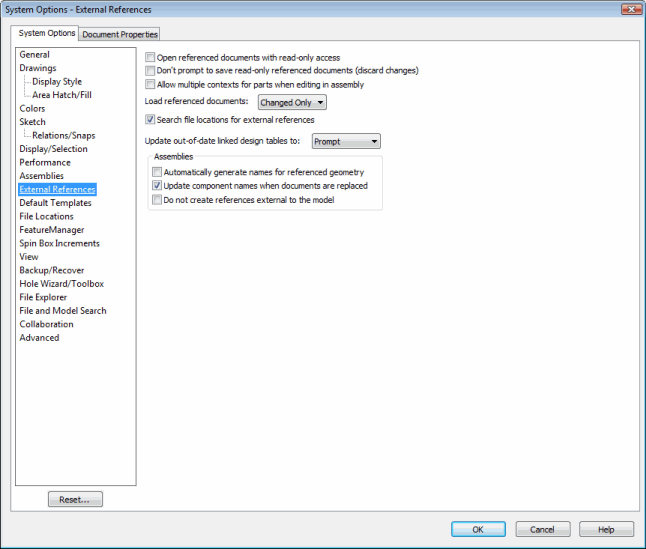

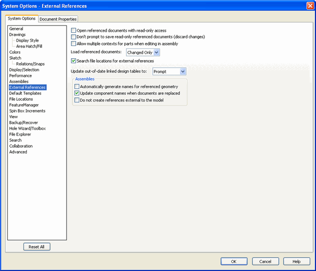

System Options > External References
Setting
Get/Set Methods
Return Value
or
<Value>
or
<OnFlag>
Comment
Open referenced documents with read-only access
ISldWorks::GetUserPreferenceToggle(swUserPreferenceToggle_e.swExtRefOpenReadOnly)
ISldWorks::SetUserPreferenceToggle(swUserPreferenceToggle_e.swExtRefOpenReadOnly, <OnFlag>)
Boolean value
Specifies whether to open referenced documents as read-only
Don't prompt to save read-only referenced documents (discard changes)
ISldWorks::GetUserPreferenceToggle(swUserPreferenceToggle_e. swExtRefNoPromptOrSave)
ISldWorks::SetUserPreferenceToggle(swUserPreferenceToggle_e. swExtRefNoPromptOrSave, <OnFlag>)
Boolean value
Specifies whether to close read-only reference documents without prompting or attempting to save changes made to them when saving or closing the parent document
Allow multiple contexts for parts when editing in assembly
ISldWorks::GetUserPreferenceToggle(swUserPreferenceToggle_e. swExtRefMultipleContexts)
ISldWorks::SetUserPreferenceToggle(swUserPreferenceToggle_e. swExtRefMultipleContexts, <OnFlag>)
Boolean value
Specifies whether to create external references to a single part from more than one assembly context
Load referenced documents
ISldWorks::GetUserPreferenceIntegerValue(swUserPreferenceIntegerValue_e. swLoadExternalReferences)
ISldWorks::SetUserPreferenceIntegerValue(swUserPreferenceIntegerValue_e. swLoadExternalReferences, swLoadExternalReferences_e.<Value>)
See swLoadExternalReferences_e for valid options
Search file locations for external references
ISldWorks::GetUserPreferenceToggle(swUserPreferenceToggle_e. swUseFolderSearchRules)
ISldWorks::SetUserPreferenceToggle(swUserPreferenceToggle_e. swUseFolderSearchRules, <OnFlag>)
Boolean value
Specifies to search the Referenced Documents list of folders in the File Locations Options dialog
Update out-of-date linked design tables to
ISldWorks::GetUserPreferenceIntegerValue(swUserPreferenceIntegerValue_e. swExternalReferencesUpdateOutOfDateLinkedDesignTable)
ISldWorks::SetUserPreferenceIntegerValue(swUserPreferenceIntegerValue_e. swExternalReferencesUpdateOutOfDateLinkedDesignTable, swExternalReferencesUpdateOutOfDateLinkedDesignTable_e.<Value>)
See swExternalReferencesUpdateOutOfDateLinkedDesignTable_e for valid options
Assemblies - Automatically generate names for referenced geometry
ISldWorks::GetUserPreferenceToggle(swUserPreferenceToggle_e. swExtRefAutoGenNames)
ISldWorks::SetUserPreferenceToggle(swUserPreferenceToggle_e. swExtRefAutoGenNames, <OnFlag>)
Boolean value
Specifies whether to automatically generate names for referenced geometry
Assemblies - Update component names when documents are replaced
ISldWorks::GetUserPreferenceToggle(swUserPreferenceToggle_e. swExtRefUpdateCompNames)
ISldWorks::SetUserPreferenceToggle(swUserPreferenceToggle_e. swExtRefUpdateCompNames, <OnFlag>)
Boolean value
Specifies whether to mate to read-only parts using internal face IDs of the parts or to replace components using surface identifiers to write-access parts
Assemblies - do not create references external to the model
ISldWorks::GetUserPreferenceToggle(swUserPreferenceToggle_e. swExternalReferencesDisable)
ISldWorks::SetUserPreferenceToggle(swUserPreferenceToggle_e. swExternalReferencesDisable, <OnFlag>)
Boolean value
Specifies whether to create external references when designing in the context of an assembly
