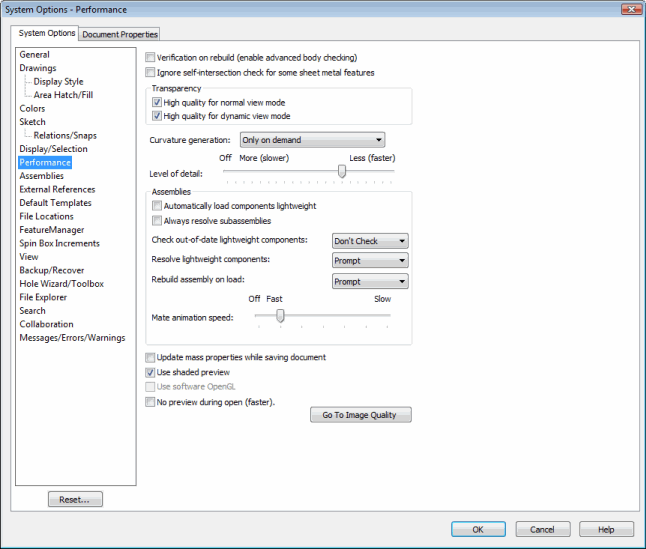

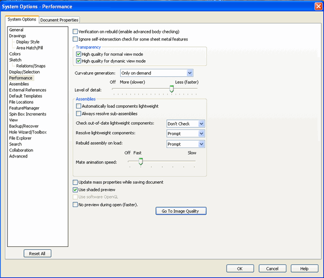

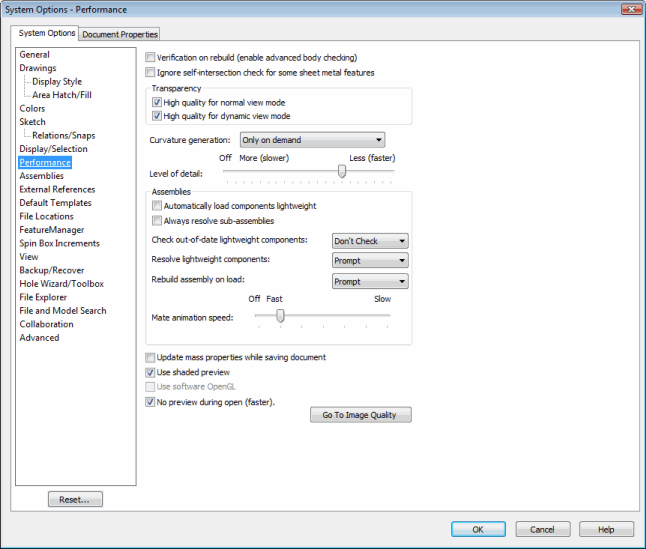

This topic contains two tables. The information in the table:
  • appearing immediately after the screen capture of the System Options - Performance dialog corresponds to the settings on that dialog.
