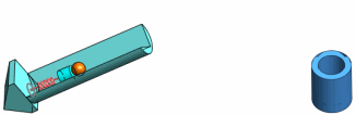

You define the optimal spring constant of a catapult that launches a projectile to hit a target with the minimum impact force.
You create a design study to find the required spring constant of a catapult designed for launching a projectile that hits a target at a certain distance.
Catapult
To open the model, go to install_dir\samples\whatsnew\Optimization\catapult.sldasm.
You need to install the Motion Simulation add-in to complete the tutorial.
Review the Motion Analysis study features:
  • Linear spring
  • Gravity load
  • Two body contact sets
  • Two result plots for tracking the contact force between the projectile and the target, and the X - component of the projectile's linear displacement.
  • Two sensors that track the motion analysis result plots.
