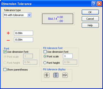

| Setting | Get/Set Methods | Return Value or <Value> | Comments |
| Tolerance type | IModelDocExtension::GetUserPreferenceInteger(swUserPreferenceIntegerValue_e.swDetailingToleranceStyle,
 swUserPreferenceOption_e.<UserPrefOption>) IModelDocExtension::SetUserPreferenceInteger(swUserPreferenceIntegerValue_e.swDetailingToleranceStyle,
 swUserPreferenceOption_e.<UserPrefOption>,
 swTolType_e.<Value>) | See swTolType_e
 for valid options |   |
| + Maximum tolerance value | IModelDocExtension::GetUserPreferenceDouble(swUserPreferenceDoubleValue_e.swDetailingMaxToleranceValue,
 swUserPreferenceOption_e.<UserPrefOption>) IModelDocExtension::SetUserPreferenceDouble(swUserPreferenceDoubleValue_e.swDetailingMaxToleranceValue,
 <Value>) | Double value | Specifies the maximum tolerance for dimensions in a drawing document |
| — Minimum tolerance value | IModelDocExtension::GetUserPreferenceDouble(swUserPreferenceDoubleValue_e.swDetailingMinToleranceValue,
 swUserPreferenceOption_e.<UserPrefOption>) IModelDocExtension::SetUserPreferenceDouble(swUserPreferenceDoubleValue_e.swDetailingMinToleranceValue,
 <Value>) | Double value | Specifies the minimum tolerance for dimensions in a drawing document |
| Font - Use dimension font | IModelDocExtension::GetUserPreferenceToggle(swUserPreferenceToggle_e.swDetailingDimensionsToleranceUseDimensionFont,
 swUserPreferenceOption_e.<UserPrefOption>) IModelDocExtension::SetUserPreferenceToggle(swUserPreferenceToggle_e.swDetailingDimensionsToleranceUseDimensionFont,
 <Value>) | Boolean value | Specifies whether to change font size for dimension tolerance text |
| Font - Size by scale or height | IModelDocExtension::GetUserPreferenceInteger(swUserPreferenceIntegerValue_e.swDetailingToleranceTextSizing,
 swUserPreferenceOption_e.<UserPrefOption>) IModelDocExtension::SetUserPreferenceInteger(swUserPreferenceIntegerValue_e.swDetailingToleranceTextSizing,
 swDetailingToleranceTextSizing_e.<Value>) | See swDetailingToleranceTextSizing_e
 for valid options; depending on the option chosen, also set either font
 scale value or font height value | Specifies how to size the tolerance text |
| Font - Font scale value | IModelDocExtension::GetUserPreferenceDouble(swUserPreferenceDoubleValue_e.swDetailingToleranceTextScale,
 swUserPreferenceOption_e.<UserPrefOption>) IModelDocExtension::SetUserPreferenceDouble(swUserPreferenceDoubleValue_e.swDetailingToleranceTextScale,
 <Value>) | Double value (0 - 10.0) | Specifies value to scale tolerance font |
| Font - Font height value | IModelDocExtension::GetUserPreferenceDouble(swUserPreferenceDoubleValue_e.swDetailingToleranceTextHeight,
 swUserPreferenceOption_e.<UserPrefOption>) IModelDocExtension::SetUserPreferenceDouble(swUserPreferenceDoubleValue_e.swDetailingToleranceTextHeight,
 <Value>) | Double value in meters | Specifies height of tolerance font |
| Fit tolerance font - Use dimension font | IModelDocExtension::GetUserPreferenceToggle(swUserPreferenceToggle_e.swDetailingDimensionsToleranceFitToUseDimensionFont,
 swUserPreferenceOption_e.<UserPrefOption>) IModelDocExtension::SetUserPreferenceToggle(swUserPreferenceToggle_e.swDetailingDimensionsToleranceFitToUseDimensionFont,
 <Value>) | Boolean value | For Fit and Fit-with-tolerance tolerance types only; specifies whether
 to use dimension tolerance text |
| Fit tolerance font - Size by scale or height | IModelDocExtension::GetUserPreferenceInteger(swUserPreferenceIntegerValue_e.swDetailingToleranceFitTolTextSizing,
 swUserPreferenceOption_e.<UserPrefOption>) IModelDocExtension::SetUserPreferenceInteger(swUserPreferenceIntegerValue_e.swDetailingToleranceFitTolTextSizing,
 for valid options; depending on the option chosen, also set either fit
 tolerance font scale value or font height value | For Fit and Fit-with-tolerance tolerance types only;Specifies how to
 size the fit tolerance text |
| Fit tolerance font - Font scale  | IModelDocExtension::GetUserPreferenceDouble(swUserPreferenceDoubleValue_e.swDetailingToleranceFitTolTextScale,
 swUserPreferenceOption_e.<UserPrefOption>) IModelDocExtension::SetUserPreferenceDouble(swUserPreferenceDoubleValue_e.swDetailingToleranceFitTolTextScale,
 <Value>) | Double value (0 - 10.0) | For Fit and Fit-with-tolerance tolerance types only;Specifies scale
 for fit tolerance font |
| Fit tolerance font - Font height  | IModelDocExtension::GetUserPreferenceDouble(swUserPreferenceDoubleValue_e.swDetailingToleranceFitTolTextHeight,
 swUserPreferenceOption_e.<UserPrefOption>) IModelDocExtension::SetUserPreferenceDouble(swUserPreferenceDoubleValue_e.swDetailingToleranceFitTolTextHeight,
 <Value>) | Double value in meters | For Fit and Fit-with-tolerance tolerance types onlySpecifies height
 of fit tolerance font |
| Show parentheses | IModelDocExtension::GetUserPreferenceToggle(swUserPreferenceToggle_e.swDetailingDimensionsToleranceUseParentheses,
 swUserPreferenceOption_e.<UserPrefOption>) IModelDocExtension::SetUserPreferenceToggle(swUserPreferenceToggle_e.swDetailingDimensionsToleranceUseParentheses,
 <Value>) | Boolean value | For Bilateral, Symmetric, or Fit-with-tolerance tolerance types only;
 specifies whether to show parentheses around linear tolerances |
| Fit tolerance display | IModelDocExtension::GetUserPreferenceInteger(swUserPreferenceIntegerValue_e.swDetailingToleranceFitTolDisplay,
 swUserPreferenceOption_e.<UserPrefOption>) IModelDocExtension::SetUserPreferenceInteger(swUserPreferenceIntegerValue_e.swDetailingToleranceFitTolDisplay,
 swFitTolDisplay_e.<Value>) | See swFitTolDisplay_e
 for valid options | For Fit and Fit-with-tolerance tolerance types only |
