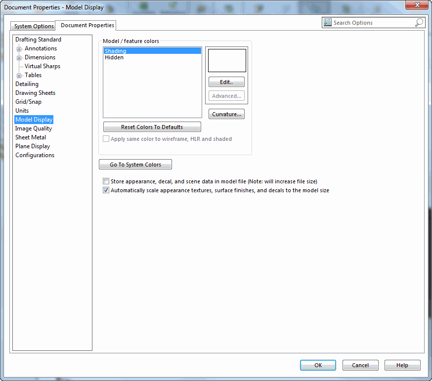

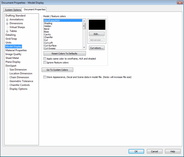

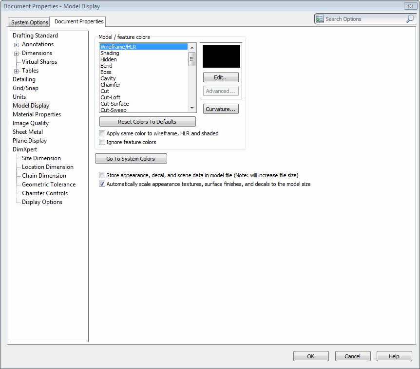

Document Properties > Model Display
Setting
Get/Set Methods
Return Value or <Value>
Comments
Model/Feature colors - Wireframe/HLR
IModelDocExtension::GetUserPreferenceInteger(swUserPreferenceIntegerValue_e.swDocumentColorWireFrame, swUserPreferenceOption_e.swDetailingNoOptionSpecified)
IModelDocExtension::SetUserPreferenceInteger(swUserPreferenceIntegerValue_e.swDocumentColorWireFrame, swUserPreferenceOption_e.swDetailingNoOptionSpecified, <Value>)
See IColorTable for valid options

Model/Feature colors - Apply same color to wireframe, HLR, and shaded
IModelDocExtension::GetUserPreferenceToggle(swUserPreferenceToggle_e.swColorsWireframeHLRShadedSame, swUserPreferenceOption_e.swDetailingNoOptionSpecified)
IModelDocExtension::SetUserPreferenceToggle(swUserPreferenceToggle_e.swColorsWireframeHLRShadedSame, swUserPreferenceOption_e.swDetailingNoOptionSpecified, <Value>)
Boolean value
Specifies whether to apply same color to wireframe, HLR, and shaded
Model/Feature colors - Ignore feature colors
IModelDocExtension::GetUserPreferenceToggle(swUserPreferenceToggle_e.swIgnoreFeatureColors, swUserPreferenceOption_e.swDetailingNoOptionSpecified)
IModelDocExtension::SetUserPreferenceToggle(swUserPreferenceToggle_e.swIgnoreFeatureColors, swUserPreferenceOption_e.swDetailingNoOptionSpecified, <Value>)
Boolean value
For parts only; specifies whether to ignore feature colors
Store appearance, decal, and scene data in model file
IModelDocExtension::GetUserPreferenceToggle(swUserPreferenceToggle_e.swStoreImagesWithModel, swUserPreferenceOption_e.swDetailingNoOptionSpecified)
IModelDocExtension::SetUserPreferenceToggle(swUserPreferenceToggle_e.swStoreImagesWithModel, swUserPreferenceOption_e.swDetailingNoOptionSpecified, <Value>)
Boolean value
Specifies whether to store images with model
Automatically scale appearance textures, surface finishes, and decals to the model size
IModelDocExtension::GetUserPreferenceToggle(swUserPreferenceToggle_e.swAutoScaleTextureSFDecalsToModelSize, swUserPreferenceOption_e.swDetailingNoOptionSpecified)
IModelDocExtension::SetUserPreferenceToggle(swUserPreferenceToggle_e.swAutoScaleTextureSFDecalsToModelSize, swUserPreferenceOption_e.swDetailingNoOptionSpecified, <Value>)
Boolean value
Page:   Document Properties > Model Display
Web Help Content Version: API Help (English only) 2013 SP05
