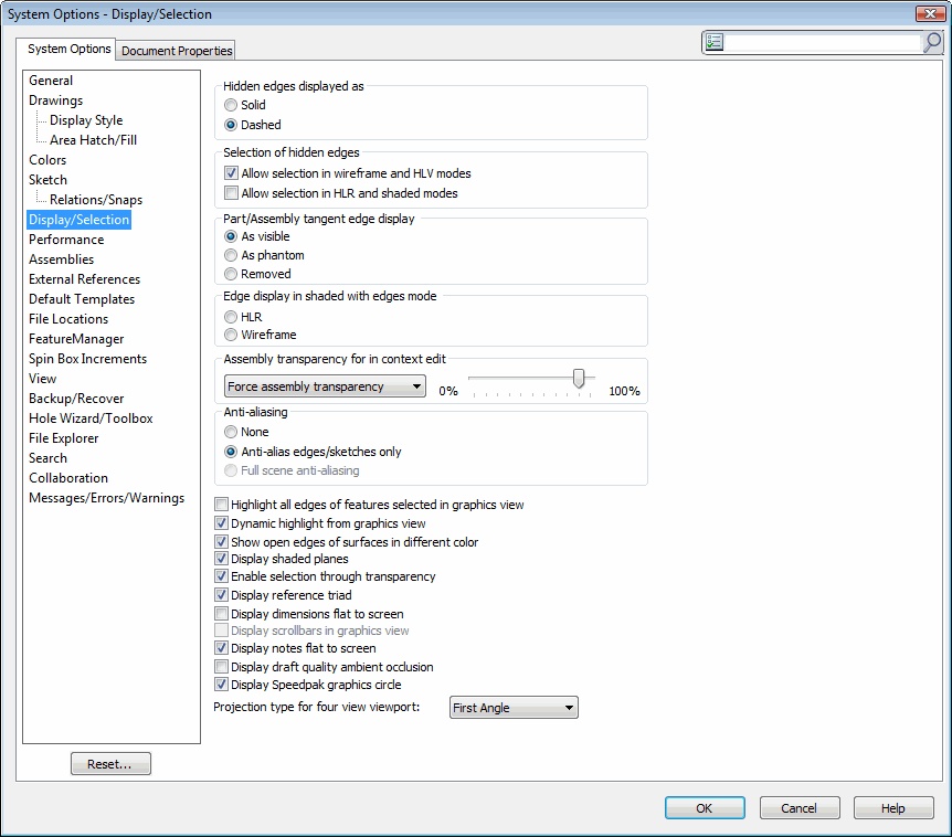

System Options - Display/Selection
This topic contains two tables. The information in the table:
  • appearing immediately after the screen capture of the System Options - Display/Selection dialog corresponds to the settings on that dialog.
  • titled Obsolete Enumerators contains enumerators that previously appeared on the System Options - Display/Selection dialog, but are now obsolete and no longer appear on that dialog.
