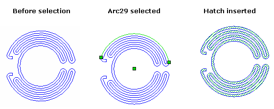

This example shows how to insert a hatch on a closed sketch in a drawing. The following image demonstrates the example.
' Preconditions: Drawing containing a closed sketch is open.
' Postconditions: Hatch is inserted.
