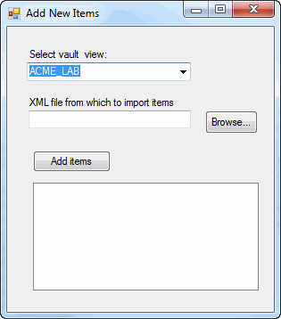

Add Items Example (C#)
This example shows how to add items to a vault. The data for the items is imported from an XML file, which is read by the .NET XmlReader.

//     f. Create a form similar to the form shown above and change:
//        1. Top label to VaultsLabel.
//        2. Combo box to VaultsComboBox.
//        3. Second label to XmlLabel.
//        4. Text box to XmlTextBox.
//        5. Browse button to BrowseButton.
//        6. Add items button to AddItemsButton.
//        7. List box to ItemsListBox.

//  1. Displays a dialog.
//  2. Select a vault.
//  3. Click the Browse button, locate and select Items.xml, and click Open.
//  4. Click the Add items button.
//     The new items are printed in the dialog's list.

        private void InitializeComponent()
            this.VaultsLabel = new System.Windows.Forms.Label();
            this.VaultsComboBox = new System.Windows.Forms.ComboBox();
            this.XmlLabel = new System.Windows.Forms.Label();
            this.XmlTextBox = new System.Windows.Forms.TextBox();
            this.BrowseButton = new System.Windows.Forms.Button();
            this.AddItemsButton = new System.Windows.Forms.Button();
            this.ItemsListBox = new System.Windows.Forms.ListBox();
            this.XmlOpenFileDialog = new System.Windows.Forms.OpenFileDialog();
            this.SuspendLayout();
            //XmlOpenFileDialog
            this.XmlOpenFileDialog.Filter = "XML files|*.XML";
            // VaultsLabel
            this.VaultsLabel.AutoSize = true;
            this.VaultsLabel.Location = new System.Drawing.Point(22, 22);
            this.VaultsLabel.Name = "VaultsLabel";
            this.VaultsLabel.Size = new System.Drawing.Size(91, 13);
            this.VaultsLabel.TabIndex = 0;
            this.VaultsLabel.Text = "Select vault view:";
            // VaultsComboBox
            this.VaultsComboBox.FormattingEnabled = true;
            this.VaultsComboBox.Location = new System.Drawing.Point(25, 38);
            this.VaultsComboBox.Name = "VaultsComboBox";
            this.VaultsComboBox.Size = new System.Drawing.Size(174, 21);
            this.VaultsComboBox.TabIndex = 1;
            // XmlLabel
            this.XmlLabel.AutoSize = true;
            this.XmlLabel.Location = new System.Drawing.Point(25, 91);
            this.XmlLabel.Name = "XmlLabel";
            this.XmlLabel.Size = new System.Drawing.Size(172, 13);
            this.XmlLabel.TabIndex = 2;
            this.XmlLabel.Text = "XML file from which to import items:";
            // XmlTextBox
            this.XmlTextBox.Location = new System.Drawing.Point(28, 107);
            this.XmlTextBox.Name = "XmlTextBox";
            this.XmlTextBox.Size = new System.Drawing.Size(171, 20);
            this.XmlTextBox.TabIndex = 3;
            // BrowseButton
            this.BrowseButton.Location = new System.Drawing.Point(216, 107);
            this.BrowseButton.Name = "BrowseButton";
            this.BrowseButton.Size = new System.Drawing.Size(75, 23);
            this.BrowseButton.TabIndex = 4;
            this.BrowseButton.Text = "Browse...";
            this.BrowseButton.UseVisualStyleBackColor = true;
            this.BrowseButton.Click += new System.EventHandler(this.BrowseButton_Click);
            // AddItemsButton
            this.AddItemsButton.Location = new System.Drawing.Point(28, 149);
            this.AddItemsButton.Name = "AddItemsButton";
            this.AddItemsButton.Size = new System.Drawing.Size(75, 23);
            this.AddItemsButton.TabIndex = 5;
            this.AddItemsButton.Text = "Add items";
            this.AddItemsButton.UseVisualStyleBackColor = true;
            this.AddItemsButton.Click += new System.EventHandler(this.AddItemsButton_Click);
            // ItemListBox
            this.ItemsListBox.FormattingEnabled = true;
            this.ItemsListBox.Location = new System.Drawing.Point(28, 196);
            this.ItemsListBox.Name = "ItemsListBox";
            this.ItemsListBox.Size = new System.Drawing.Size(263, 95);
            this.ItemsListBox.TabIndex = 6;
            // Form1
            this.AutoScaleDimensions = new System.Drawing.SizeF(6F, 13F);
            this.AutoScaleMode = System.Windows.Forms.AutoScaleMode.Font;
            this.ClientSize = new System.Drawing.Size(334, 311);
            this.Controls.Add(this.ItemsListBox);
            this.Controls.Add(this.AddItemsButton);
            this.Controls.Add(this.BrowseButton);
            this.Controls.Add(this.XmlTextBox);
            this.Controls.Add(this.XmlLabel);
            this.Controls.Add(this.VaultsComboBox);
            this.Controls.Add(this.VaultsLabel);
            this.Name = "Form1";
            this.Text = "Add new items";
            this.Load  += new System.EventHandler(this.AddItems_Load);
            this.ResumeLayout(false);
            this.PerformLayout();
        #endregion
