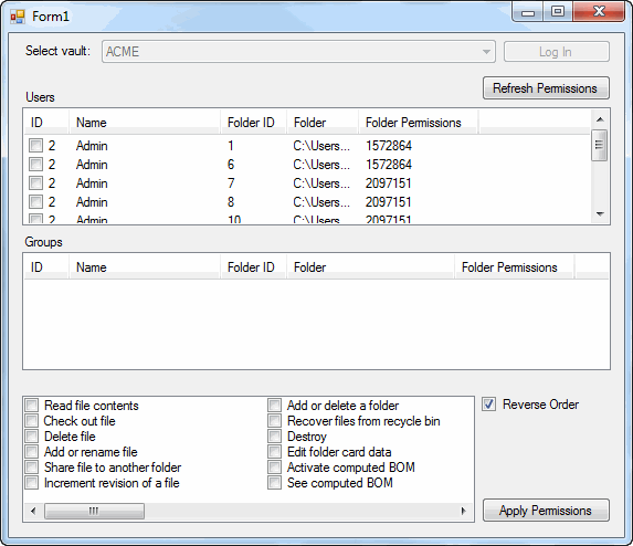

This example shows how to create an application that displays a form in which a user can assign permissions to folders for users and groups in a vault.

//  2. Click File > New > Project > Visual Basic > Windows Forms Application.
//  3. Type CallingCSharp in Name.
//  4. Click Browse and navigate to the folder where to create the project.
//  5. Click OK.
//  6. Create a form similar to the form shown above with the following names for the form controls:
//     a. Label1 (label control with text, "Select vault:")
//     b. comboVault (combo box control)
//     c. buttonLogIn (button with text, "Log In")
//     d. Label2 (label with text, "Users")
//     e. buttonRefresh (button with text, "Refresh Permissions")
//     f. listViewUsers (list view control)
//        ColumnHeader1 (ID)
//        ColumnHeader2 (Name)
//        ColumnHeader3 (Folder ID)
//        ColumnHeader7 (Folder)
//        ColumnHeader8 (Folder Permissions)
//     g. Label3 (label with text, "Groups")
//     h. listViewGroups (list view control)
//        ColumnHeader4 (ID)
//        ColumnHeader5 (Name)
//        ColumnHeader6 (Folder ID)
//        ColumnHeader9 (Folder)
//        ColumnHeader10 (Folder Permissions)
//     i. listViewPermissions (list view control)
//     j. checkboxReverseOrder (check box with text, "Reverse Order")
//     k. buttonApply (button with text, "Apply Permissions")
//  7. Replace the code in Form1.cs with this code.
//  8. Replace the code in Form1.Designer.cs with this code.
//  9. Add EPDM.Interop.epdm.dll as a reference (right-click the project
//     name in the Solution Explorer, click Add Reference, click Assemblies > Framework in the
//     left-side panel, browse to the top folder of your SolidWorks Enterprise PDM installation,
//     locate and click EPDM.Interop.epdm.dll, click Open, click Add, and click Close).
// 10. Right-click References > EPDM.Interop.epdm, click Properties, and set
//     Embed Interop Types to False to handle methods
//     that pass arrays of structures.
// 11. Click Debug > Start Debugging or press F5.
// Postconditions:
// 1. In the Form1 dialog, select a vault and click Log In.
//    Wait for the application to populate the Users and Groups list boxes.
// 2. Click permissions in the list box located left of the Reverse Order check box.
// 3. Optionally select the Reverse Order check box.
// 4. Select the check boxes in front of the users and folders to which to assign permissions.
// 5. Click Apply Permissions.
//    Wait for the application to populate the Users list.
//    The folder permissions are updated for the selected users.
// 6. Select the check boxes in front of the groups and folders to which to assign permissions.
// 7. Click Apply Permissions.
//    Wait for the application to populate the Groups list.
//    The folder permissions are updated for the selected groups.

        /// <summary>
        /// Required method for Designer support - do not modify
        /// the contents of this method with the code editor.
        /// </summary>
        private void InitializeComponent()
            this.buttonLogIn = new System.Windows.Forms.Button();
            this.label2 = new System.Windows.Forms.Label();
            this.buttonRefresh = new System.Windows.Forms.Button();
            this.label3 = new System.Windows.Forms.Label();
            this.checkboxReverseOrder = new System.Windows.Forms.CheckBox();
            this.buttonApply = new System.Windows.Forms.Button();
            this.listViewUsers = new System.Windows.Forms.ListView();
            this.columnHeader1 = ((System.Windows.Forms.ColumnHeader)(new System.Windows.Forms.ColumnHeader()));
            this.columnHeader2 = ((System.Windows.Forms.ColumnHeader)(new System.Windows.Forms.ColumnHeader()));
            this.columnHeader3 = ((System.Windows.Forms.ColumnHeader)(new System.Windows.Forms.ColumnHeader()));
            this.columnHeader7 = ((System.Windows.Forms.ColumnHeader)(new System.Windows.Forms.ColumnHeader()));
            this.columnHeader8 = ((System.Windows.Forms.ColumnHeader)(new System.Windows.Forms.ColumnHeader()));
            this.listViewGroups = new System.Windows.Forms.ListView();
            this.columnHeader4 = ((System.Windows.Forms.ColumnHeader)(new System.Windows.Forms.ColumnHeader()));
            this.columnHeader5 = ((System.Windows.Forms.ColumnHeader)(new System.Windows.Forms.ColumnHeader()));
            this.columnHeader6 = ((System.Windows.Forms.ColumnHeader)(new System.Windows.Forms.ColumnHeader()));
            this.columnHeader9 = ((System.Windows.Forms.ColumnHeader)(new System.Windows.Forms.ColumnHeader()));
            this.columnHeader10 = ((System.Windows.Forms.ColumnHeader)(new System.Windows.Forms.ColumnHeader()));
            this.listViewPermissions = new System.Windows.Forms.ListView();
            this.comboVault = new System.Windows.Forms.ComboBox();
            this.label4 = new System.Windows.Forms.Label();
            this.SuspendLayout();
            // buttonLogIn
            this.buttonLogIn.Location = new System.Drawing.Point(518, 27);
            this.buttonLogIn.Name = "buttonLogIn";
            this.buttonLogIn.Size = new System.Drawing.Size(75, 23);
            this.buttonLogIn.TabIndex = 2;
            this.buttonLogIn.Text = "Log In";
            this.buttonLogIn.UseVisualStyleBackColor = true;
            this.buttonLogIn.Click += new System.EventHandler(this.buttonLogIn_Click);
            // label2
            this.label2.AutoSize = true;
            this.label2.Location = new System.Drawing.Point(38, 85);
            this.label2.Name = "label2";
            this.label2.Size = new System.Drawing.Size(37, 13);
            this.label2.TabIndex = 3;
            this.label2.Text = "Users";
            // buttonRefresh
            this.buttonRefresh.Location = new System.Drawing.Point(518, 75);
            this.buttonRefresh.Name = "buttonRefresh";
            this.buttonRefresh.Size = new System.Drawing.Size(126, 23);
            this.buttonRefresh.TabIndex = 4;
            this.buttonRefresh.Text = "Refresh Permissions";
            this.buttonRefresh.UseVisualStyleBackColor = true;
            this.buttonRefresh.Click += new System.EventHandler(this.buttonRefresh_Click);
            // label3
            this.label3.AutoSize = true;
            this.label3.Location = new System.Drawing.Point(38, 227);
            this.label3.Name = "label3";
            this.label3.Size = new System.Drawing.Size(44, 13);
            this.label3.TabIndex = 6;
            this.label3.Text = "Groups";
            // checkboxReverseOrder
            this.checkboxReverseOrder.AutoSize = true;
            this.checkboxReverseOrder.Location = new System.Drawing.Point(518, 368);
            this.checkboxReverseOrder.Name = "checkboxReverseOrder";
            this.checkboxReverseOrder.Size = new System.Drawing.Size(95, 17);
            this.checkboxReverseOrder.TabIndex = 9;
            this.checkboxReverseOrder.Text = "Reverse Order";
            this.checkboxReverseOrder.UseVisualStyleBackColor = true;
            // buttonApply
            this.buttonApply.Location = new System.Drawing.Point(518, 407);
            this.buttonApply.Name = "buttonApply";
            this.buttonApply.Size = new System.Drawing.Size(126, 23);
            this.buttonApply.TabIndex = 10;
            this.buttonApply.Text = "Apply Permissions";
            this.buttonApply.UseVisualStyleBackColor = true;
            this.buttonApply.Click += new System.EventHandler(buttonApply_Click);
            // listViewUsers
            this.listViewUsers.CheckBoxes = true;
            this.listViewUsers.Columns.AddRange(new System.Windows.Forms.ColumnHeader[] {
            this.columnHeader1,
            this.columnHeader2,
            this.columnHeader3,
            this.columnHeader7,
            this.columnHeader8});
            this.listViewUsers.Location = new System.Drawing.Point(38, 112);
            this.listViewUsers.Name = "listViewUsers";
            this.listViewUsers.Size = new System.Drawing.Size(501, 97);
            this.listViewUsers.TabIndex = 11;
            this.listViewUsers.UseCompatibleStateImageBehavior = false;
            this.listViewUsers.View = System.Windows.Forms.View.Details;
            // columnHeader1
            this.columnHeader1.Text = "ID";
            this.columnHeader1.Width = 41;
            // columnHeader2
            this.columnHeader2.Text = "Name";
            this.columnHeader2.Width = 137;
            // columnHeader3
            this.columnHeader3.Text = "Folder ID";
            // columnHeader7
            this.columnHeader7.Text = "Folder";
            this.columnHeader7.Width = 152;
            // columnHeader8
            this.columnHeader8.Text = "Folder Permissions";
            this.columnHeader8.Width = 108;
            // listViewGroups
            this.listViewGroups.CheckBoxes = true;
            this.listViewGroups.Columns.AddRange(new System.Windows.Forms.ColumnHeader[] {
            this.columnHeader4,
            this.columnHeader5,
            this.columnHeader6,
            this.columnHeader9,
            this.columnHeader10});
            this.listViewGroups.Location = new System.Drawing.Point(38, 257);
            this.listViewGroups.Name = "listViewGroups";
            this.listViewGroups.Size = new System.Drawing.Size(501, 97);
            this.listViewGroups.TabIndex = 12;
            this.listViewGroups.UseCompatibleStateImageBehavior = false;
            this.listViewGroups.View = System.Windows.Forms.View.Details;
            // columnHeader4
            this.columnHeader4.Text = "ID";
            this.columnHeader4.Width = 41;
            // columnHeader5
            this.columnHeader5.Text = "Name";
            this.columnHeader5.Width = 137;
            // columnHeader6
            this.columnHeader6.Text = "Folder ID";
            // columnHeader9
            this.columnHeader9.Text = "Folder";
            this.columnHeader9.Width = 152;
            // columnHeader10
            this.columnHeader10.Text = "Folder Permissions";
            this.columnHeader10.Width = 108;
            // listViewPermissions
            this.listViewPermissions.CheckBoxes = true;
            this.listViewPermissions.Location = new System.Drawing.Point(38, 383);
            this.listViewPermissions.Name = "listViewPermissions";
            this.listViewPermissions.Size = new System.Drawing.Size(431, 97);
            this.listViewPermissions.TabIndex = 13;
            this.listViewPermissions.UseCompatibleStateImageBehavior = false;
            this.listViewPermissions.View = System.Windows.Forms.View.List;
            // comboVault
            this.comboVault.FormattingEnabled = true;
            this.comboVault.Location = new System.Drawing.Point(108, 27);
            this.comboVault.Name = "comboVault";
            this.comboVault.Size = new System.Drawing.Size(361, 21);
            this.comboVault.TabIndex = 14;
            // label4
            this.label4.AutoSize = true;
            this.label4.Location = new System.Drawing.Point(38, 27);
            this.label4.Name = "label4";
            this.label4.Size = new System.Drawing.Size(66, 13);
            this.label4.TabIndex = 15;
            this.label4.Text = "Select vault:";
            // Form1
            this.AutoScaleDimensions = new System.Drawing.SizeF(6F, 13F);
            this.AutoScaleMode = System.Windows.Forms.AutoScaleMode.Font;
            this.ClientSize = new System.Drawing.Size(749, 516);
            this.Controls.Add(this.label4);
            this.Controls.Add(this.comboVault);
            this.Controls.Add(this.listViewPermissions);
            this.Controls.Add(this.listViewGroups);
            this.Controls.Add(this.listViewUsers);
            this.Controls.Add(this.buttonApply);
            this.Controls.Add(this.checkboxReverseOrder);
            this.Controls.Add(this.label3);
            this.Controls.Add(this.buttonRefresh);
            this.Controls.Add(this.label2);
            this.Controls.Add(this.buttonLogIn);
            this.Name = "Form1";
            this.Text = "Folder Permissions";
            this.Load += new System.EventHandler(this.Form1_Load);
            this.ResumeLayout(false);
            this.PerformLayout();
        #endregion
