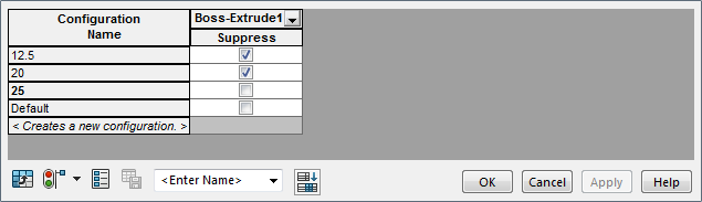

Modify Configurations
The Modify Configurations dialog box provides a table where you can create and modify configurations for commonly configured parameters in parts and assemblies.
Alternatively, you can create and modify configurations manually or with a design table.

Working with the Table
You can manipulate the table to:
  • Add and remove feature parameters
  • Change which configuration is active
  • Rearrange columns
You can name and save multiple views of the table for future reference and editing.
Tables are saved in the Tables folder on the ConfigurationManager tab.
