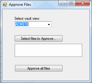

' Postconditions:
'  1. The Approve Files dialog box displays.
'     a. Select a vault view.
'     b. Click Select files to approve.
'     c. In the Select File dialog:
'        1. Select vault files in the Waiting for Approval state.
'        2. Click Open.
'     d. Click Approve all files.
'  2. Click OK in the Do Transition dialog box.
'     The selected files change to the Approved state using the Passed Approval
'     transition.
'  3. Close the Approve Files dialog box.

        Me.BatchChange.TabIndex = 6
        Me.BatchChange.Text = "Approve all files"
        Me.BatchChange.UseVisualStyleBackColor = True
