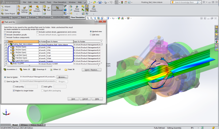

When using Pack and Go, SOLIDWORKS Flow Simulation results are included in the folder or zip file that you create.
Click File > Pack and Go. In the Pack and Go dialog box, select Include simulation results and click Save.
