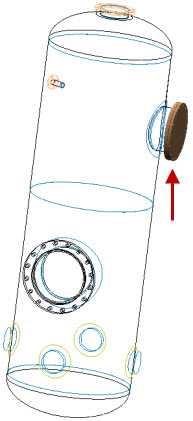

For parts which failed to mesh, you can launch the Mesh Failure Diagnostic tool, to render these parts in shaded display mode in the graphics area. Meshed parts are rendered in wireframe display mode.
Click Show bodies which failed to mesh.

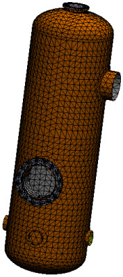

Click Show mesh for all bodies to view the meshed bodies only.
You can double-click a body listed in the Mesh Failure Diagnostics pane to zoom-in the body in the graphics area.
View with active option Show bodies which failed to mesh. View with active option Show mesh for all bodies.
