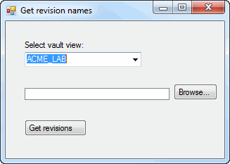

//  5. Click Debug > Start Debugging or press F5.
// Postconditions:
//  1. Displays the Get revision names dialog box.
//  2. Select a vault view.
//  3. Click Browse.
//  4. Displays the Select a file dialog box.
//     a. Click the file identified in Preconditions step 4 in the
//        selected vault.
//     b. Click Open.
//        The selected file's path and file name appear
//        in the Select a file dialog box.
//  5. Click Get revisions
//  6. Displays a message box:
//     * telling you that a local copy of the selected file does not exist.
//       - or -
//     * telling you that the selected file does not have a revision scheme.
//       - or -
//     * showing you a list of the names of the revisions for the selected file.
//  7. Click OK to close the message box.
//  8. Close the Get revision names dialog box.

//Form1.Designer.cs
namespace RevisionCSharp
    partial class Form1
        /// <summary>
        /// Required designer variable.
        /// </summary>
        private System.ComponentModel.IContainer components = null;
        /// <summary>
        /// Clean up any resources being used.
        /// </summary>
        /// <param name="disposing">true if managed resources should be disposed; otherwise, false.</param>
        protected override void Dispose(bool disposing)
            if (disposing && (components != null))
                components.Dispose();
            base.Dispose(disposing);
        #region Windows Form Designer generated code
        /// <summary>
        /// Required method for Designer support - do not modify
        /// the contents of this method with the code editor.
        /// </summary>
        private void InitializeComponent()
            this.VaultsLabel = new System.Windows.Forms.Label();
            this.VaultsComboBox = new System.Windows.Forms.ComboBox();
            this.FileListBox = new System.Windows.Forms.ListBox();
            this.BrowseButton = new System.Windows.Forms.Button();
            this.RevisionButton = new System.Windows.Forms.Button();
            this.OpenFileDialog1 = new System.Windows.Forms.OpenFileDialog();
            this.SuspendLayout();
            // VaultsLabel
            this.VaultsLabel.AutoSize = true;
            this.VaultsLabel.Location = new System.Drawing.Point(23, 13);
            this.VaultsLabel.Name = "VaultsLabel";
            this.VaultsLabel.Size = new System.Drawing.Size(91, 13);
            this.VaultsLabel.TabIndex = 0;
            this.VaultsLabel.Text = "Select vault view:";
            // VaultsComboBox
            this.VaultsComboBox.FormattingEnabled = true;
            this.VaultsComboBox.Location = new System.Drawing.Point(26, 30);
            this.VaultsComboBox.Name = "VaultsComboBox";
            this.VaultsComboBox.Size = new System.Drawing.Size(220, 21);
            this.VaultsComboBox.TabIndex = 1;
            // FileListBox
            this.FileListBox.FormattingEnabled = true;
            this.FileListBox.Location = new System.Drawing.Point(26, 90);
            this.FileListBox.Name = "FileListBox";
            this.FileListBox.Size = new System.Drawing.Size(167, 17);
            this.FileListBox.TabIndex = 2;
            // BrowseButton
            this.BrowseButton.Location = new System.Drawing.Point(199, 84);
            this.BrowseButton.Name = "BrowseButton";
            this.BrowseButton.Size = new System.Drawing.Size(75, 23);
            this.BrowseButton.TabIndex = 3;
            this.BrowseButton.Text = "Browse...";
            this.BrowseButton.TextAlign = System.Drawing.ContentAlignment.MiddleLeft;
            this.BrowseButton.UseVisualStyleBackColor = true;
            this.BrowseButton.Click += new System.EventHandler(BrowseButton_Click);
            // OpenFileDialog1
            this.OpenFileDialog1.FileName = "OpenFileDialog1";
            this.OpenFileDialog1.Multiselect = true;
            this.OpenFileDialog1.Title = "Select a file";
            // RevisionButton
            this.RevisionButton.Location = new System.Drawing.Point(26, 137);
            this.RevisionButton.Name = "RevisionButton";
            this.RevisionButton.Size = new System.Drawing.Size(88, 23);
            this.RevisionButton.TabIndex = 4;
            this.RevisionButton.Text = "Get revisions";
            this.RevisionButton.TextAlign = System.Drawing.ContentAlignment.MiddleLeft;
            this.RevisionButton.UseVisualStyleBackColor = true;
            this.RevisionButton.Click += new System.EventHandler(RevisionButton_Click);
            // Form1
            this.AutoScaleDimensions = new System.Drawing.SizeF(6F, 13F);
            this.AutoScaleMode = System.Windows.Forms.AutoScaleMode.Font;
            this.ClientSize = new System.Drawing.Size(284, 187);
            this.Controls.Add(this.RevisionButton);
            this.Controls.Add(this.BrowseButton);
            this.Controls.Add(this.FileListBox);
            this.Controls.Add(this.VaultsComboBox);
            this.Controls.Add(this.VaultsLabel);
            this.Name = "Form1";
            this.Text = "Get revision names";
            this.Load += new System.EventHandler(Form1_Load);
            this.ResumeLayout(false);
            this.PerformLayout();
        #endregion
        private System.Windows.Forms.Label VaultsLabel;
        private System.Windows.Forms.ComboBox VaultsComboBox;
        private System.Windows.Forms.ListBox FileListBox;
        private System.Windows.Forms.Button BrowseButton;
        private System.Windows.Forms.Button RevisionButton;
        private System.Windows.Forms.OpenFileDialog OpenFileDialog1;
