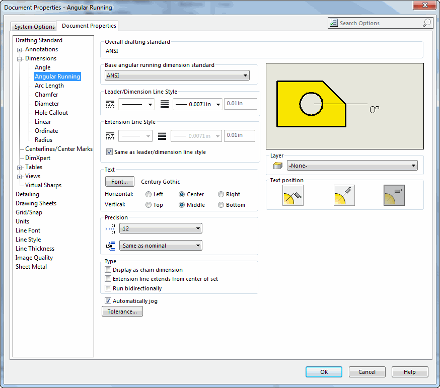

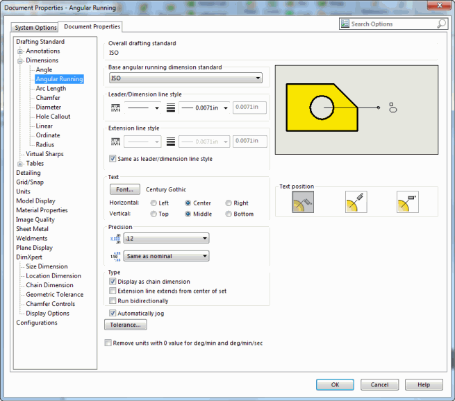

Document Properties > Dimensions > Angular Running
Setting
Get/Set Methods
Return Value or <Value>
Comments
Base angular running dimension standard
IModelDocExtension::GetUserPreferenceInteger(swUserPreferenceIntegerValue_e.swDetailingDimensionStandard, swUserPreferenceOption_e.swDetailingAngularRunningDimension)
IModelDocExtension::SetUserPreferenceInteger(swUserPreferenceIntegerValue_e.swDetailingDimensionStandard, swUserPreferenceOption_e.swDetailingAngularRunningDimension, swDetailingStandard_e.<Value>)
See swDetailingStandard_e for valid options
Specifies the base angular running dimensioning standard to use
Leader/Dimension Line Style - Leader Style
IModelDocExtension::GetUserPreferenceInteger(swUserPreferenceIntegerValue_e.swLineFontDimensionsStyle, swUserPreferenceOption_e.swDetailingAngularRunningDimension)
IModelDocExtension::SetUserPreferenceInteger(swUserPreferenceIntegerValue_e.swLineFontDimensionsStyle, swUserPreferenceOption_e.swDetailingAngularRunningDimension, swLineStyles_e.<Value>)
See swLineStyles_e for valid options
Specifies style of leader lines for angular running dimensions
Leader/Dimension Line Style - Leader Thickness
IModelDocExtension::GetUserPreferenceInteger(swUserPreferenceIntegerValue_e.swLineFontDimensionsThickness, swUserPreferenceOption_e.swDetailingAngularRunningDimension)
IModelDocExtension::SetUserPreferenceInteger(swUserPreferenceIntegerValue_e.swLineFontDimensionsThickness, swUserPreferenceOption_e.swDetailingAngularRunningDimension, swLineWeights_e.<Value>)
See swLineWeights_e for valid options
Specifies thickness of leader lines for angular running dimensions
Leader/Dimension Line Style - Custom Thickness
IModelDocExtension::GetUserPreferenceDouble(swUserPreferenceDoubleValue_e.swLineFontDimensionsThicknessCustom, swUserPreferenceOption_e.swDetailingAngularRunningDimension)
IModelDocExtension::SetUserPreferenceDouble(swUserPreferenceDoubleValue_e.swLineFontDimensionsThicknessCustom, swUserPreferenceOption_e.swDetailingAngularRunningDimension, <Value>)
Double value
Specifies a custom thickness for leader lines in angular running dimensions; sets Custom Thickness to the specified thickness and Leader Thickness to Custom Size
Extension Line Style - Extension Line Style
IModelDocExtension::GetUserPreferenceInteger(swUserPreferenceIntegerValue_e.swDimensionsExtensionLineStyle, swUserPreferenceOption_e.swDetailingAngularRunningDimension)
IModelDocExtension::SetUserPreferenceInteger(swUserPreferenceIntegerValue_e.swDimensionsExtensionLineStyle, swUserPreferenceOption_e.swDetailingAngularRunningDimension, swLineStyles_e.<Value>)
Specifies style of extension lines for angular running dimensions
Extension Line Style - Extension Line Thickness
IModelDocExtension::GetUserPreferenceInteger(swUserPreferenceIntegerValue_e.swDimensionsExtensionLineStyleThickness, swUserPreferenceOption_e.swDetailingAngularRunningDimension)
IModelDocExtension::SetUserPreferenceInteger(swUserPreferenceIntegerValue_e.swDimensionsExtensionLineStyleThickness, swUserPreferenceOption_e.swDetailingAngularRunningDimension, swLineWeights_e.<Value>)
Specifies thickness of extension lines for angular running dimensions
Extension Line Style - Custom Thickness
IModelDocExtension::GetUserPreferenceDouble(swUserPreferenceDoubleValue_e.swDimensionsExtensionLineStyleThicknessCustom, swUserPreferenceOption_e.swDetailingAngularRunningDimension)
IModelDocExtension::SetUserPreferenceDouble(swUserPreferenceDoubleValue_e.swDimensionsExtensionLineStyleThicknessCustom, swUserPreferenceOption_e.swDetailingAngularRunningDimension, <Value>)
Double value
Specifies a custom thickness for extension lines in angular running dimensions; sets Custom Thickness to the specified thickness and Extension Line Thickness to Custom Size
Extension Line Style - Same as leader/dimension line style
IModelDocExtension::GetUserPreferenceToggle(swUserPreferenceToggle_e.swDimensionsExtensionLineStyleSameAsLeader, swUserPreferenceOption_e.swDetailingAngularRunningDimension)
IModelDocExtension::SetUserPreferenceToggle(swUserPreferenceToggle_e.swDimensionsExtensionLineStyleSameAsLeader, swUserPreferenceOption_e.swDetailingAngularRunningDimension, <Value>)
Boolean value
Specifies whether the extension line style is the same as the leader/dimension line style
Text - Font...
IModelDocExtension::GetUserPreferenceTextFormat(swUserPreferenceTextFormat_e.swDetailingDimensionTextFormat, swUserPreferenceOption_e.swDetailingAngularRunningDimension)
IModelDocExtension::SetUserPreferenceTextFormat(swUserPreferenceTextFormat_e.swDetailingDimensionTextFormat, swUserPreferenceOption_e.swDetailingAngularRunningDimension, <Value>)
See ITextFormat for font options
To set font property values, implement ITextFormat, set the appropriate ITextFormat member values, and pass the ITextFormat object in the API set method
Text - Horizontal
IModelDocExtension::GetUserPreferenceInteger(swUserPreferenceIntegerValue_e.swDetailingDimensionTextAlignmentHorizontal, swUserPreferenceOption_e.swDetailingAngularRunningDimension)
IModelDocExtension::SetUserPreferenceInteger(swUserPreferenceIntegerValue_e.swDetailingDimensionTextAlignmentHorizontal, swUserPreferenceOption_e.swDetailingAngularRunningDimension, swTextJustification_e.<Value>)
See swTextJustification_e for valid options
Text - Vertical
IModelDocExtension::GetUserPreferenceInteger(swUserPreferenceIntegerValue_e.swDetailingDimensionTextAlignmentVertical, swUserPreferenceOption_e.swDetailingAngularRunningDimension)
IModelDocExtension::SetUserPreferenceInteger(swUserPreferenceIntegerValue_e.swDetailingDimensionTextAlignmentVertical, swUserPreferenceOption_e.swDetailingAngularRunningDimension, swTextAlignmentVertical_e.<Value>)
See swTextAlignmentVertical_e for valid options
Precision - Unit Precision
IModelDocExtension::GetUserPreferenceInteger(swUserPreferenceIntegerValue_e.swDetailingLinearDimPrecision, swUserPreferenceOption_e.swDetailingAngularRunningDimension)
IModelDocExtension::SetUserPreferenceInteger(swUserPreferenceIntegerValue_e.swDetailingLinearDimPrecision, swUserPreferenceOption_e.swDetailingAngularRunningDimension, <Value>)
Number of decimal places to display; 0 through 8
Specifies primary precision for linear dimension
Precision - Tolerance Precision
IModelDocExtension::GetUserPreferenceInteger(swUserPreferenceIntegerValue_e.swDetailingLinearTolPrecision, swUserPreferenceOption_e.swDetailingAngularRunningDimension)
IModelDocExtension::SetUserPreferenceInteger(swUserPreferenceIntegerValue_e.swDetailingLinearTolPrecision, swUserPreferenceOption_e.swDetailingAngularRunningDimension, swDimensionPrecisionSettings_e .<Value>)
See swDimensionPrecisionSettings_e for valid options
Specifies primary precision for tolerance
Type - Display as chain dimension
IModelDocExtension::GetUserPreferenceToggle(swUserPreferenceToggle_e.swDetailingAngularRunningDisplayAsChain, swUserPreferenceOption_e.swDetailingAngularRunningDimension)
IModelDocExtension::SetUserPreferenceToggle(swUserPreferenceToggle_e.swDetailingAngularRunningDisplayAsChain, swUserPreferenceOption_e.swDetailingAngularRunningDimension, <Value>)
Boolean value
Specifies whether to display angular running dimensions as chain dimensions
Type - Extension line extends from center of set
IModelDocExtension::GetUserPreferenceToggle(swUserPreferenceToggle_e.swDetailingAngularRunningExtensionLineExtend, swUserPreferenceOption_e.swDetailingAngularRunningDimension)
IModelDocExtension::SetUserPreferenceToggle(swUserPreferenceToggle_e.swDetailingAngularRunningExtensionLineExtend, swUserPreferenceOption_e.swDetailingAngularRunningDimension, <Value>)
Boolean value
Specifies whether to extend the angular running dimension extension line from center of set
Type - Run bidirectionally
IModelDocExtension::GetUserPreferenceToggle(swUserPreferenceToggle_e.swDetailingAngularRunningRunBidirectionally, swUserPreferenceOption_e.swDetailingAngularRunningDimension)
IModelDocExtension::SetUserPreferenceToggle(swUserPreferenceToggle_e.swDetailingAngularRunningRunBidirectionally, swUserPreferenceOption_e.swDetailingAngularRunningDimension, <Value>)
Boolean value
Specifies whether to display bidirectional angular running dimensions
Automatically jog
ModelDocExtension::GetUserPreferenceToggle(swUserPreferenceToggle_e.swDetailingDimsAutoJogAngularRunning, swUserPreferenceOption_e.swDetailingAngularRunningDimension)
IModelDocExtension::SetUserPreferenceToggle(swUserPreferenceToggle_e.swDetailingDimsAutoJogAngularRunning, swUserPreferenceOption_e.swDetailingAngularRunningDimension, <Value>)
Boolean value
Specifies whether to automatically jog angular running dimensions
Tolerance...
See Comments
See Comments
See Dimension Tolerance
Layer
IModelDocExtension::GetUserPreferenceString(swUserPreferenceStringValue_e.swDetailingLayer, swUserPreferenceOption_e.swDetailingAngularRunningDimension)
IModelDocExtension::SetUserPreferenceString(swUserPreferenceStringValue_e.swDetailingLayer, swUserPreferenceOption_e.swDetailingAngularRunningDimension, <Value>)
Valid Options:
  • "Border"
  • "Dimensions"
  • "Notes"
  • "BOM"
  • "FORMAT"
This setting is available only on drawings; depending on drawing, some options may not apply
Text position
IModelDocExtension::GetUserPreferenceInteger(swUserPreferenceIntegerValue_e.swDetailingDimensionTextAndLeaderStyle, swUserPreferenceOption_e.swDetailingAngularRunningDimension)
IModelDocExtension::SetUserPreferenceInteger(swUserPreferenceIntegerValue_e.swDetailingDimensionTextAndLeaderStyle, swUserPreferenceOption_e.swDetailingAngularRunningDimension, swDisplayDimensionLeaderText_e.<Value>)
See swDisplayDimensionLeaderText_e for valid options
Specifies how to display angular running dimension text
Remove units with 0 value for deg/min and deg/min/sec
IModelDocExtension::GetUserPreferenceToggle(swUserPreferenceToggle_e.swDetailingAndDimensionsRemoveInsignificantZeros, swUserPreferenceOption_e.swDetailingAngularRunningDimension)
IModelDocExtension::SetUserPreferenceToggle(swUserPreferenceToggle_e.swDetailingAndDimensionsRemoveInsignificantZeros, swUserPreferenceOption_e.swDetailingAngularRunningDimension, <Value>)
Boolean value
Specifies whether to hide angular running  dimension units when equal to 0 deg/min or 0 deg/min/sec
