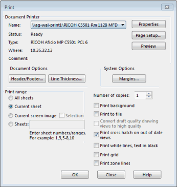

File > Print
Setting
Get/Set Methods
Return Value
or
<Value>
or
<OnFlag>
Comment
Name
See Comment
See Comment
Not currently available in SOLIDWORKS API
Document Options - Header/Footer
See Comment
See Comment
Document Options - Line Thickness
See Comment
See Comment
See Document Properties > Line Thickness
System Options - Margins
See Comment
See Comment
See File > Page Setup > Print > System Options > Margins
Print range - Entire model
See Comment
See Comment
Print range - Current sheet
See Comment
See Comment
Print range - Current screen image
See Comment
See Comment
Print range - Sheets
See Comment
See Comment
Print range - Sheets - <n>
See Comment
See Comment
Number of copies <n>
See Comment
See Comment
Print background
ISldWorks::GetUserPreferenceToggle(swUserPreferenceToggle_e.swPrintBackground) ISldWorks::SetUserPreferenceToggle(swUserPreferenceToggle_e.swPrintBackground, <OnFlag>)
Boolean value
Specifies whether to print the window background, in addition to the model and drawing
Print to file
See Comment
See Comment
Convert draft quality drawing views to high quality
See Comment
See Comment
Print cross hatch on out of date views
See Comment
See Comment
Print white lines, text in black See Comment See Comment
Print grid ISldWorks::GetUserPreferenceToggle(swUserPreferenceToggle_e.swPrintGrid) ISldWorks::SetUserPreferenceToggle(swUserPreferenceToggle_e.swPrintGrid, <OnFlag>) Boolean value Specifies whether to print the grid
Print zone lines ISldWorks::GetUserPreferenceToggle(swUserPreferenceToggle_e.swPrintZoneLines) ISldWorks::SetUserPreferenceToggle(swUserPreferenceToggle_e.swPrintZoneLines, <OnFlag>) Boolean value Specifies whether to print zone lines
