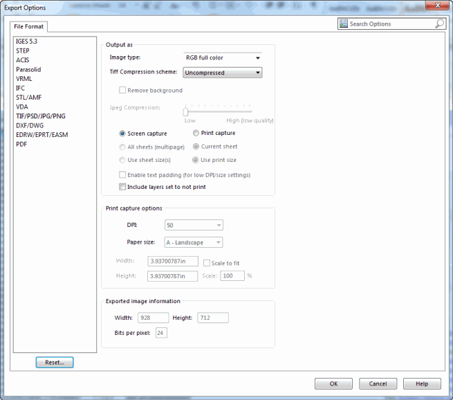

File > Save As > Save as type > Tif or Adobe PhotoShop Files or JPEG > Options > TIF/PSD/JPG
Setting
Get/Set Methods
Return Value
or
<Value>
or
<OnFlag>
Comment
Output as - Image type
ISldWorks::GetUserPreferenceIntegerValue(swUserPreferenceIntegerValue_e.swTiffImageType)
ISldWorks::SetUserPreferenceIntegerValue(swUserPreferenceIntegerValue_e.swTiffImageType, swTiffImageType_e.<Value>)
See swTiffImageType_e for valid options
Output as - Tiff Compression scheme
ISldWorks::GetUserPreferenceIntegerValue(swUserPreferenceIntegerValue_e.swTiffCompressionScheme)
ISldWorks::SetUserPreferenceIntegerValue(swUserPreferenceIntegerValue_e.swTiffCompressionScheme, swTiffCompressionScheme_e.<Value>)
See swTiffCompressionScheme_e for valid options
Output as - Remove background
See Comment
See Comment
Currently not available in the SOLIDWORKS API
Output as - Jpeg Compression
ISldWorks::GetUserPreferenceIntegerValue(swUserPreferenceIntegerValue_e.swExportJpegCompression)
ISldWorks::SetUserPreferenceIntegerValue(swUserPreferenceIntegerValue_e.swExportJpegCompression, <Value>)
Long value (1-100)
1 is for lowest compression; 100 is for highest compression (low quality)
Output as - Screen capture
ISldWorks::GetUserPreferenceIntegerValue(swUserPreferenceIntegerValue_e.swTiffScreenOrPrintCapture)
ISldWorks::SetUserPreferenceIntegerValue(swUserPreferenceIntegerValue_e.swTiffScreenOrPrintCapture, <Value>)
0
Output as - Print capture
1
Output as - All sheets (multipage)
ISldWorks::GetUserPreferenceToggle(swUserPreferenceToggle_e.swTiffPrintAllSheets)
ISldWorks::SetUserPreferenceToggle(swUserPreferenceToggle_e.swTiffPrintAllSheets, <OnFlag>)
True
For Output as - Print capture only
Output as - Current sheet
False
Output as - Use sheet size(s)
ISldWorks::GetUserPreferenceToggle(swUserPreferenceToggle_e.swTiffPrintUseSheetSize)
ISldWorks::SetUserPreferenceToggle(swUserPreferenceToggle_e.swTiffPrintUseSheetSize, <OnFlag>)
True
Output as - Use print size
False
Output as - Enable text padding (for low DPI/size settings)
ISldWorks::GetUserPreferenceToggle(swUserPreferenceToggle_e.swTiffPrintPadText)
ISldWorks::SetUserPreferenceToggle(swUserPreferenceToggle_e.swTiffPrintPadText, <OnFlag>)
Boolean value
Adjusts inter-character text spacing such that the text fills the bounding rectangle of the string; set to True when using low DPI and small paper sizes (A, A4, or A3)
Output as - Include layers set not to print
SldWorks::GetUserPreferenceToggle(swUserPreferenceToggle_e.swTIFIncludeLayersNotToPrint)
ISldWorks::SetUserPreferenceToggle(swUserPreferenceToggle_e.swTIFIncludeLayersNotToPrint, <OnFlag>)
Boolean value
Specifies whether to include layers set not to print
Print capture options - DPI
ISldWorks::GetUserPreferenceIntegerValue(swUserPreferenceIntegerValue_e.swTiffPrintDPI)
ISldWorks::SetUserPreferenceIntegerValue(swUserPreferenceIntegerValue_e.swTiffPrintDPI, <Value>)
Integer value
For drawings only; For Output as - Print capture only
Print capture options - Paper size
ISldWorks::GetUserPreferenceIntegerValue(swUserPreferenceIntegerValue_e.swTiffPrintPaperSize)
ISldWorks::SetUserPreferenceIntegerValue(swUserPreferenceIntegerValue_e.swTiffPrintPaperSize, swDwgPaperSizes_e.<Value>)
See swDwgPaperSizes_e for valid options
Print capture options - Width
ISldWorks::GetUserPreferenceDoubleValue(swUserPreferenceDoubleValue_e.swTiffPrintDrawingPaperWidth)
ISldWorks::SetUserPreferenceDoubleValue(swUserPreferenceDoubleValue_e.swTiffPrintDrawingPaperWidth, <Value>)
Double value in meters
For drawings only; For Output as - Print capture only with Print capture options - Paper size set to User Defined
Print capture options - Height
ISldWorks::GetUserPreferenceDoubleValue(swUserPreferenceDoubleValue_e.swTiffPrintDrawingPaperHeight)
ISldWorks::SetUserPreferenceDoubleValue(swUserPreferenceDoubleValue_e.swTiffPrintDrawingPaperHeight, <Value>)
Print capture options - Scale to fit
ISldWorks::GetUserPreferenceToggle(swUserPreferenceToggle_e.swTiffPrintScaleToFit)
ISldWorks::SetUserPreferenceToggle(swUserPreferenceToggle_e.swTiffPrintScaleToFit, <OnFlag>)
Boolean value
For drawings only; specifies whether to scale drawing to fit page
ISldWorks::GetUserPreferenceIntegerValue(swUserPreferenceIntegerValue_e.swTiffPrintScaleFactor)
ISldWorks::SetUserPreferenceIntegerValue(swUserPreferenceIntegerValue_e.swTiffPrintScaleFactor, <Value>)
Integer value
Specifies the scale factor
