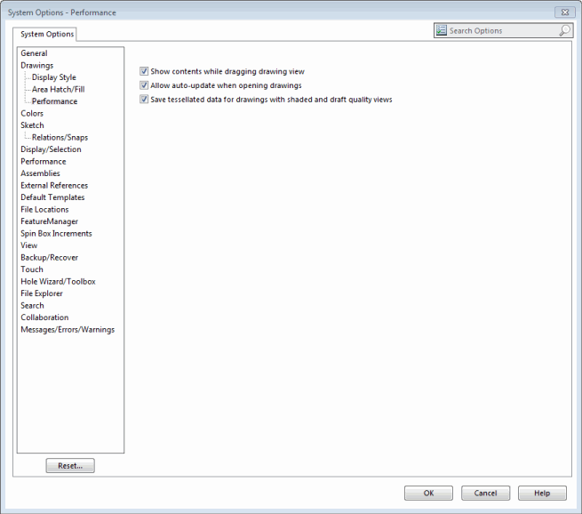

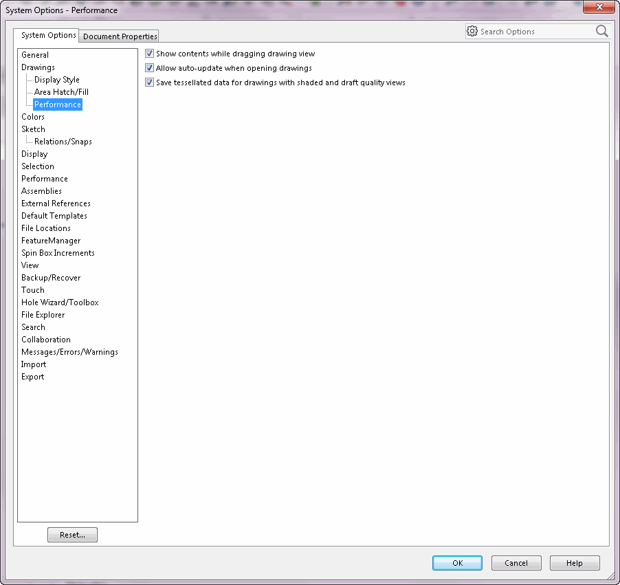

System Options > Drawings > Performance
Setting
Get/Set Methods
Return Value
or
<Value>
or
<OnFlag>
Comment
Show contents while dragging drawing view
ISldWorks::GetUserPreferenceToggle(swUserPreferenceToggle_e.swDrawingViewShowContentsWhileDragging)
ISldWorks::SetUserPreferenceToggle(swUserPreferenceToggle_e.swDrawingViewShowContentsWhileDragging, <OnFlag>)
Boolean value
Specifies whether model or view boundary is displayed when view is dragged
Allow auto-update when opening drawings
ISldWorks::GetUserPreferenceToggle(swUserPreferenceToggle_e.swAutomaticDrawingViewUpdateDefault
ISldWorks::SetUserPreferenceToggle(swUserPreferenceToggle_e.swAutomaticDrawingViewUpdateDefault, <OnFlag>)
Boolean value
Specifies whether drawing views are updated when a drawing is opened
Save tessellated data for drawings with shaded and draft quality views
ISldWorks::GetUserPreferenceToggle(swUserPreferenceToggle_e.swDrawingSaveShadedData)
ISldWorks::SetUserPreferenceToggle(swUserPreferenceToggle_e.swDrawingSaveShadedData, <OnFlag>)
Boolean value
Specifies whether to save tessellated data in drawing documents with shaded and draft quality views
Page:   System Options > Drawings > Performance
