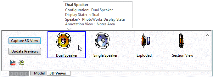

To access the 3D Views tab, click the 3D Views tab at the bottom of the SOLIDWORKS window:
A resizable pane appears at the bottom of the screen. It includes 3D View controls that let you:

Capture 3D View opens the Capture 3D View PropertyManager, where you specify the 3D view name, and the configuration, display state, and annotation view to capture.
Capture 3D View also captures information about the file, including exploded and model break views, zoom level, view orientation, section views, and the current settings from Hide/Show Items in the Heads-Up View toolbar.
When you capture a 3D view, the view name and a preview are added to the 3D Views tab. To see the details of a view, hover over its preview. To switch views, double-click a view. The view is outlined and the display in the graphics area changes to the selected view.
