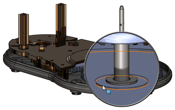

    The magnifying glass opens.
    To customize the keyboard shortcut used to start the magnifying glass, click Tools > Customize . On the Keyboard tab, search for Magnifying Glass and enter the shortcut key.
  2. Move the pointer around the model.
    The magnifying glass moves, maintaining the same degree of zoom. The model remains stationary.

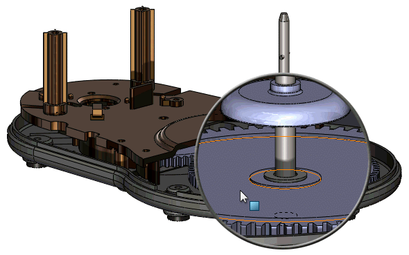

  3. Scroll the mouse wheel to zoom in.
    The model remains stationary while the magnifying glass area zooms in.

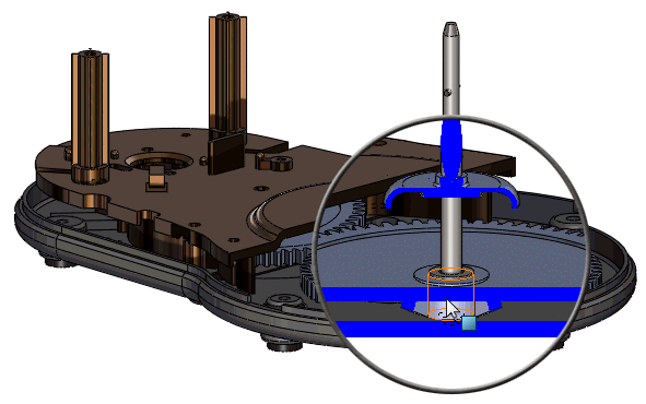

  4. Press Alt and scroll the mouse wheel to display a section view parallel to the screen.
