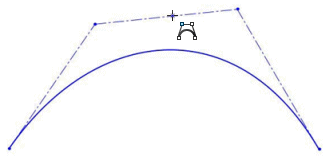

  1. In an open sketch, right click anywhere on the control polygon and select Insert Control Vertex .
    The pointer changes to Control Vertex Pointer.
  2. Hover the pointer over the control polygon segment where you want to place the control vertex and click to insert the point.
    Control Polygon1
The control polygon splits the segment at the new control vertex and the curvature adjusts accordingly.
