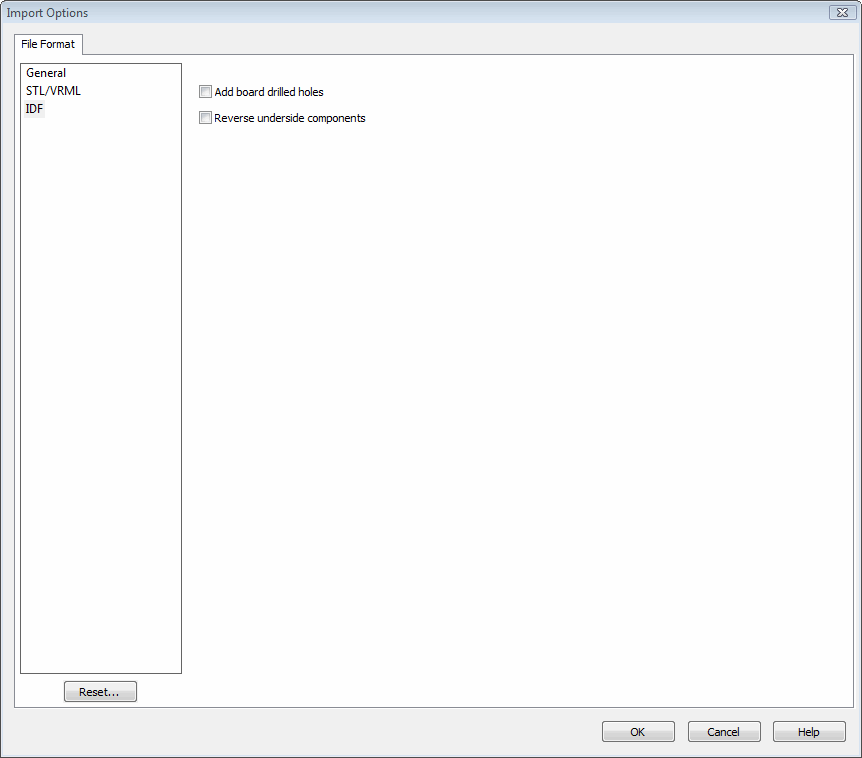

File > Open > Files of type > IDF > Options
Setting
Get/Set Methods
Return Value
or
<OnFlag>
Comment
Add board drilled holes
ISldWorks::GetUserPreferenceToggle(swUserPreferenceToggle_e.swImportIDFAddDrilledHoles)
ISldWorks::SetUserPreferenceToggle(swUserPreferenceToggle_e.swImportIDFAddDrilledHoles. <OnFlag>)
Boolean value
Specifies whether to add drilled holes from the circuit board; for Intermediate Data Format (IDF) circuit boards files only
Reverse underside components
ISldWorks::GetUserPreferenceToggle(swUserPreferenceToggle_e.swImportIDFReverseUndersideComponents)
ISldWorks::SetUserPreferenceToggle(swUserPreferenceToggle_e.swImportIDFReverseUndersideComponents. <OnFlag>)
Boolean value
Specifies whether to compensate for incorrectly rotated components by allowing proper location of the component features; for Intermediate Data Format (IDF) circuit board files only
