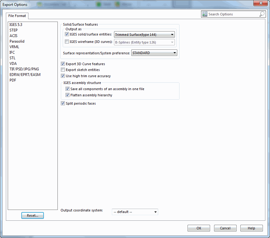

File > Save As > Save as type > IGES > Options
This topic contains two tables. The information in the table:
  • appearing immediately after the screen capture of the Export Options - File Format - IGES 5.3 dialog corresponds to the settings on that dialog.
  • titled Obsolete Enumerators contains enumerators that previously appeared on the Export Options - File Format - IGES 5.3 dialog, but are now obsolete and no longer appear on that dialog.
