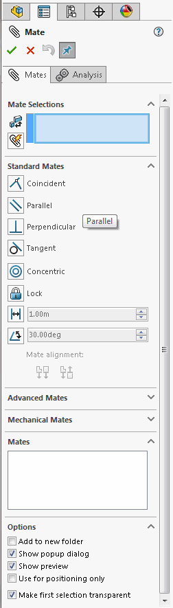

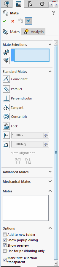

Insert > Mate (assemblies only)
Setting
Get/Set Methods
Return Value
or
<Value>
or
<OnFlag>
Comment
Options - Make first selection transparent
IModelDocExtension::GetUserPreferenceToggle(swUserPreferenceToggle_e.swMakeFirstSelectionTransparentInMateDialog, swUserPreferenceOption_e.swDetailingNoOptionSpecified)
IModelDocExtension::SetUserPreferenceToggle(swUserPreferenceToggle_e.swMakeFirstSelectionTransparentInMateDialog, swUserPreferenceOption_e.swDetailingNoOptionSpecified, <Value>)
Boolean value
Specifies whether to make the first mate selection transparent
