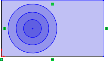

  2. Sketch three concentric circles inside a rectangle.
    The outermost circle is the lightest and the innermost circle is the darkest shade of blue.
