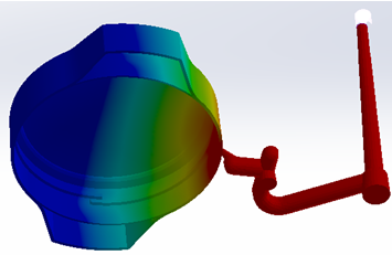

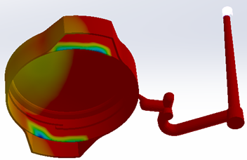

Pressure distribution after filling Pressure distribution after packing
