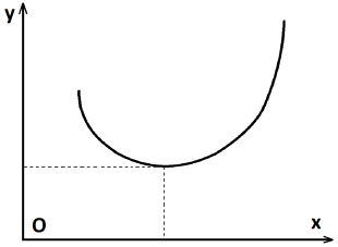

The diagram shows the variation of injection pressure (y-axis) with respect to filling time (x-axis). The U-shape diagram indicates that the optimal filling time is located at the bottom of the curve. For short or very long filling times, higher injection pressure values are required.
