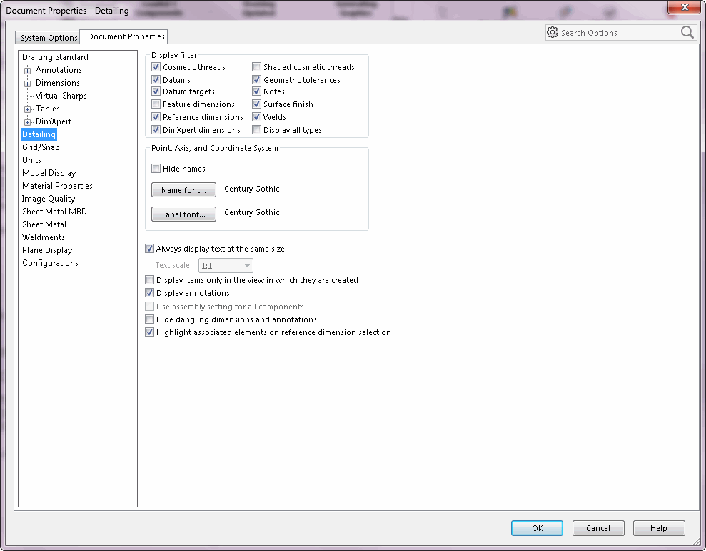

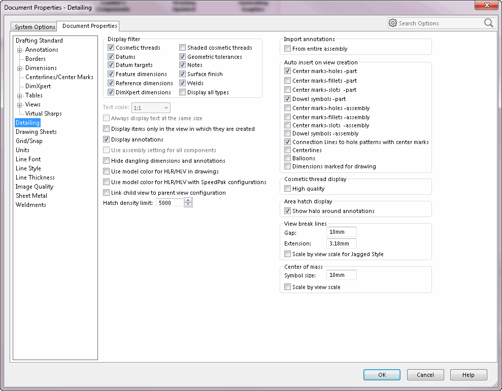

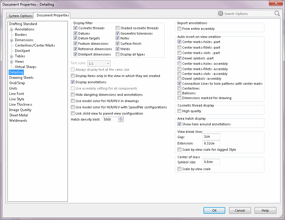

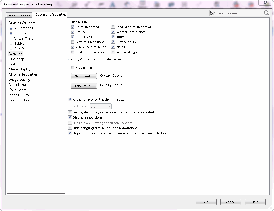

Document Properties > Detailing
For drawings:
For parts and assemblies:
Setting
Get/Set Methods
Return Value or <Value>
Comments
Display filter - Cosmetic threads
IModelDocExtension::GetUserPreferenceToggle(swUserPreferenceToggle_e.swDisplayCosmeticThreads, swUserPreferenceOption_e.swDetailingNoOptionSpecified)
IModelDocExtension::SetUserPreferenceToggle(swUserPreferenceToggle_e.swDisplayCosmeticThreads, swUserPreferenceOption_e.swDetailingNoOptionSpecified, <Value>)
Boolean value
Specifies whether to display cosmetic threads. Depends on swDisplayAnnotations setting
Display filter - Datums
IModelDocExtension::GetUserPreferenceToggle(swUserPreferenceToggle_e.swDisplayDatums, swUserPreferenceOption_e.swDetailingNoOptionSpecified)
IModelDocExtension::SetUserPreferenceToggle(swUserPreferenceToggle_e.swDisplayDatums, swUserPreferenceOption_e.swDetailingNoOptionSpecified, <Value>)
Boolean value
Specifies whether to display datums. Depends on swDisplayAnnotations setting
Display filter - Datum targets
IModelDocExtension::GetUserPreferenceToggle(swUserPreferenceToggle_e.swDisplayDatumTargets, swUserPreferenceOption_e.swDetailingNoOptionSpecified)
IModelDocExtension::SetUserPreferenceToggle(swUserPreferenceToggle_e.swDisplayDatumTargets, swUserPreferenceOption_e.swDetailingNoOptionSpecified, <Value>)
Boolean value
Specifies whether to display datum targets. Depends on swDisplayAnnotations setting
Display filter - Feature dimensions
IModelDocExtension::GetUserPreferenceToggle(swUserPreferenceToggle_e.swDisplayFeatureDimensions, swUserPreferenceOption_e.swDetailingNoOptionSpecified)
IModelDocExtension::SetUserPreferenceToggle(swUserPreferenceToggle_e.swDisplayFeatureDimensions, swUserPreferenceOption_e.swDetailingNoOptionSpecified, <Value>)
Boolean value
Specifies whether to display feature dimensions. Depends on swDisplayAnnotations setting
Display filter - Reference dimensions
IModelDocExtension::GetUserPreferenceToggle(swUserPreferenceToggle_e.swDisplayReferenceDimensions, swUserPreferenceOption_e.swDetailingNoOptionSpecified)
IModelDocExtension::SetUserPreferenceToggle(swUserPreferenceToggle_e.swDisplayReferenceDimensions, swUserPreferenceOption_e.swDetailingNoOptionSpecified, <Value>)
Boolean value
Specifies whether to display reference dimensions. Depends on swDisplayAnnotations setting
Display filter - DimXpert dimensions
IModelDocExtension::GetUserPreferenceToggle(swUserPreferenceToggle_e.swDisplayDimXpertDimensions, swUserPreferenceOption_e.swDetailingNoOptionSpecified)
IModelDocExtension::SetUserPreferenceToggle(swUserPreferenceToggle_e.swDisplayDimXpertDimensions, swUserPreferenceOption_e.swDetailingNoOptionSpecified, <Value>)
Boolean value
Specifies whether to show DimXpert dimensions
Display filter - Shaded cosmetic threads
IModelDocExtension::GetUserPreferenceToggle(swUserPreferenceToggle_e.swDisplayShadedCosmeticThreads, swUserPreferenceOption_e.swDetailingNoOptionSpecified)
IModelDocExtension::SetUserPreferenceToggle(swUserPreferenceToggle_e.swDisplayShadedCosmeticThreads, swUserPreferenceOption_e.swDetailingNoOptionSpecified, <Value>)
Boolean value
Specifies whether to display cosmetic threads shaded or not
Display filter - Geometric tolerances
IModelDocExtension::GetUserPreferenceToggle(swUserPreferenceToggle_e.swDisplayGeometricTolerances, swUserPreferenceOption_e.swDetailingNoOptionSpecified)
IModelDocExtension::SetUserPreferenceToggle(swUserPreferenceToggle_e.swDisplayGeometricTolerances, swUserPreferenceOption_e.swDetailingNoOptionSpecified, <Value>)
Boolean value
Specifies whether to display geometric tolerances. Depends on swDisplayAnnotations setting
Display filter - Notes
IModelDocExtension::GetUserPreferenceToggle(swUserPreferenceToggle_e.swDisplayNotes, swUserPreferenceOption_e.swDetailingNoOptionSpecified)
IModelDocExtension::SetUserPreferenceToggle(swUserPreferenceToggle_e.swDisplayNotes, swUserPreferenceOption_e.swDetailingNoOptionSpecified, <Value>)
Boolean value
Specifies whether to display notes. Depends on swDisplayAnnotations setting
Display filter - Surface finish
IModelDocExtension::GetUserPreferenceToggle(swUserPreferenceToggle_e.swDisplaySurfaceFinishSymbols, swUserPreferenceOption_e.swDetailingNoOptionSpecified)
IModelDocExtension::SetUserPreferenceToggle(swUserPreferenceToggle_e.swDisplaySurfaceFinishSymbols, swUserPreferenceOption_e.swDetailingNoOptionSpecified, <Value>)
Boolean value
Specifies whether to display surface-finish symbols. Depends on swDisplayAnnotations setting
Display filter - Welds
IModelDocExtension::GetUserPreferenceToggle(swUserPreferenceToggle_e.swDisplayWeldSymbols, swUserPreferenceOption_e.swDetailingNoOptionSpecified)
IModelDocExtension::SetUserPreferenceToggle(swUserPreferenceToggle_e.swDisplayWeldSymbols, swUserPreferenceOption_e.swDetailingNoOptionSpecified, <Value>)
Boolean value
Specifies whether to display weld symbols. Depends on swDisplayAnnotations setting
Display filter - Display all types
See Comments
See Comments
Not currently available in SOLIDWORKS API
Point, Axis, and Coordinate System - Hide names
IModelDocExtension::GetUserPreferenceToggle(swUserPreferenceToggle_e.swPointAxisCoordSystemHideNames, swUserPreferenceOption_e.swDetailingNoOptionSpecified)
IModelDocExtension::SetUserPreferenceToggle(swUserPreferenceToggle_e.swPointAxisCoordSystemHideNames, swUserPreferenceOption_e.swDetailingNoOptionSpecified, <Value>)
Boolean value
Specifies whether to hide names of points, axes, and coordinate systems (parts and assemblies only)
Point, Axis, and Coordinate System - Name font
IModelDocExtension::GetUserPreferenceTextFormat(swUserPreferenceTextFormat_e.swPointAxisCoordSystemNameFontTextFormat, swUserPreferenceOption_e.swDetailingNoOptionSpecified)
IModelDocExtension::SetUserPreferenceTextFormat(swUserPreferenceTextFormat_e.swPointAxisCoordSystemNameFontTextFormat, swUserPreferenceOption_e.swDetailingNoOptionSpecified, <Value>)
See ITextFormat for valid font options
To set font property values, implement ITextFormat, set the appropriate ITextFormat member values, and pass the ITextFormat object in the API set method (parts and assemblies only)
Point, Axis, and Coordinate System - Label font
IModelDocExtension::GetUserPreferenceTextFormat(swUserPreferenceTextFormat_e.swPointAxisCoordSystemLabelFontTextFormat, swUserPreferenceOption_e.swDetailingNoOptionSpecified)
IModelDocExtension::SetUserPreferenceTextFormat(swUserPreferenceTextFormat_e.swPointAxisCoordSystemLabelFontTextFormat, swUserPreferenceOption_e.swDetailingNoOptionSpecified, <Value>)
Text scale - numerator
IModelDocExtension::GetUserPreferenceDouble(swUserPreferenceDoubleValue_e.swAnnotationTextScaleNumerator, swUserPreferenceOption_e.swDetailingNoOptionSpecified)
IModelDocExtension::SetUserPreferenceDouble(swUserPreferenceDoubleValue_e.swAnnotationTextScaleNumerator, swUserPreferenceOption_e.swDetailingNoOptionSpecified, <Value>)
Double value
Specifies numerator for annotation text scale
Text scale - denominator
IModelDocExtension::GetUserPreferenceDouble(swUserPreferenceDoubleValue_e.swAnnotationTextScaleDenominator, swUserPreferenceOption_e.swDetailingNoOptionSpecified)
IModelDocExtension::SetUserPreferenceDouble(swUserPreferenceDoubleValue_e.swAnnotationTextScaleDenominator, swUserPreferenceOption_e.swDetailingNoOptionSpecified, <Value>)
Double value
Specifies denominator for annotation text scale
Always display text at the same size
IModelDocExtension::GetUserPreferenceToggle(swUserPreferenceToggle_e.swDisplayTextAtSameSizeAlways, swUserPreferenceOption_e.swDetailingNoOptionSpecified)
IModelDocExtension::SetUserPreferenceToggle(swUserPreferenceToggle_e.swDisplayTextAtSameSizeAlways, swUserPreferenceOption_e.swDetailingNoOptionSpecified, <Value>)
Boolean value
Specifies whether to display all annotations and dimensions at same size regardless of zoom. Drawings have this option disabled and always zoom the text height
Display items only in the view in which they are created
IModelDocExtension::GetUserPreferenceToggle(swUserPreferenceToggle_e.swDisplayOnlyInViewOfCreation, swUserPreferenceOption_e.swDetailingNoOptionSpecified)
IModelDocExtension::SetUserPreferenceToggle(swUserPreferenceToggle_e.swDisplayOnlyInViewOfCreation, swUserPreferenceOption_e.swDetailingNoOptionSpecified, <Value>)
Boolean value
Specifies whether to only display an annotation when model is viewed in same orientation as when annotation was added
Display annotations
IModelDocExtension::GetUserPreferenceToggle(swUserPreferenceToggle_e.swDisplayAnnotations, swUserPreferenceOption_e.swDetailingNoOptionSpecified)
IModelDocExtension::SetUserPreferenceToggle(swUserPreferenceToggle_e.swDisplayAnnotations, swUserPreferenceOption_e.swDetailingNoOptionSpecified, <Value>)
Boolean value
Specifies whether to display annotations
Use assembly setting for all components
IModelDocExtension::GetUserPreferenceToggle(swUserPreferenceToggle_e.swDisplayAnnotationsUseAssemblySettings, swUserPreferenceOption_e.swDetailingNoOptionSpecified)
IModelDocExtension::SetUserPreferenceToggle(swUserPreferenceToggle_e.swDisplayAnnotationsUseAssemblySettings, swUserPreferenceOption_e.swDetailingNoOptionSpecified, <Value>)
Boolean value
For assemblies only. Specifies whether to display all annotations for the assembly document, regardless of the setting in the individual part documents
Hide dangling dimensions and annotations
IModelDocExtension::GetUserPreferenceToggle(swUserPreferenceToggle_e.swAnnotationDisplayHideDanglingDim, swUserPreferenceOption_e.swDetailingNoOptionSpecified)
IModelDocExtension::SetUserPreferenceToggle(swUserPreferenceToggle_e.swAnnotationDisplayHideDanglingDim, swUserPreferenceOption_e.swDetailingNoOptionSpecified, <Value>)
Boolean value
Specifies whether to hide dangling dimensions and annotations in drawings
Highlight associated elements on reference dimension selection
IModelDocExtension::GetUserPreferenceToggle(swUserPreferenceToggle_e.swDetailingHighlightElements, swUserPreferenceOption_e.swDetailingNoOptionSpecified)
IModelDocExtension::SetUserPreferenceToggle(swUserPreferenceToggle_e.swDetailingHighlightElements, swUserPreferenceOption_e.swDetailingNoOptionSpecified, <Value>)
Boolean value
Specifies whether to highlight elements associated with selected reference dimensions (for parts and assemblies only)
Use model color for HLR/HLV in drawings
IModelDocExtension::GetUserPreferenceToggle(swUserPreferenceToggle_e.swUseModelColorInDrawings, swUserPreferenceOption_e.swDetailingNoOptionSpecified)
IModelDocExtension::SetUserPreferenceToggle(swUserPreferenceToggle_e.swUseModelColorInDrawings, swUserPreferenceOption_e.swDetailingNoOptionSpecified, <Value>)
Boolean value
Specifies whether to use model color for hidden lines that are removed/visible
Use model color for HLR/HLV with SpeedPak configurations
IModelDocExtension::GetUserPreferenceToggle(swUserPreferenceToggle_e.swUseSpeedpakModelColorInDrawings, swUserPreferenceOption_e.swDetailingNoOptionSpecified)
IModelDocExtension::SetUserPreferenceToggle(swUserPreferenceToggle_e.swUseSpeedpakModelColorInDrawings, swUserPreferenceOption_e.swDetailingNoOptionSpecified, <Value>)
Boolean value
Specifies whether to use model color for HLR/HLV with SpeedPak configurations; only available when a drawing of an assembly is open
Link child view to parent view configuration
IModelDocExtension::GetUserPreferenceToggle(swUserPreferenceToggle_e.swDetailingLinkParentViewConfiguration, swUserPreferenceOption_e.swDetailingNoOptionSpecified)
IModelDocExtension::SetUserPreferenceToggle(swUserPreferenceToggle_e.swDetailingLinkParentViewConfiguration, swUserPreferenceOption_e.swDetailingNoOptionSpecified, <Value>)
Boolean value
Specifies whether to link the child view to parent view configurations
Import annotations - From entire assembly
IModelDocExtension::GetUserPreferenceToggle(swUserPreferenceToggle_e.swDetailingImportEntireAssemblyAnnotations, swUserPreferenceOption_e.swDetailingNoOptionSpecified)
IModelDocExtension::SetUserPreferenceToggle(swUserPreferenceToggle_e.swDetailingImportEntireAssemblyAnnotations, swUserPreferenceOption_e.swDetailingNoOptionSpecified, <Value>)
Boolean value
Specifies whether to import annotations from the entire assembly
Auto insert on view creation - Center marks-holes -part
IModelDocExtension::GetUserPreferenceToggle(swUserPreferenceToggle_e.swDetailingAutoInsertCenterMarksForHoles, swUserPreferenceOption_e.swDetailingNoOptionSpecified)
IModelDocExtension::SetUserPreferenceToggle(swUserPreferenceToggle_e.swDetailingAutoInsertCenterMarksForHoles, swUserPreferenceOption_e.swDetailingNoOptionSpecified, <Value>)
Boolean value
Specifies whether to automatically insert center marks for holes in parts
Auto insert on view creation - Center marks-fillets -part
IModelDocExtension::GetUserPreferenceToggle(swUserPreferenceToggle_e.swDetailingAutoInsertCenterMarksForFillets, swUserPreferenceOption_e.swDetailingNoOptionSpecified)
IModelDocExtension::SetUserPreferenceToggle(swUserPreferenceToggle_e.swDetailingAutoInsertCenterMarksForFillets, swUserPreferenceOption_e.swDetailingNoOptionSpecified, <Value>)
Boolean value
Specifies whether to automatically insert center marks for fillets in parts
Auto insert on view creation - Center marks-slots -part
IModelDocExtension::GetUserPreferenceToggle(swUserPreferenceToggle_e.swDetailingAutoInsertCenterMarksForSlots, swUserPreferenceOption_e.swDetailingNoOptionSpecified)
IModelDocExtension::SetUserPreferenceToggle(swUserPreferenceToggle_e.swDetailingAutoInsertCenterMarksForSlots, swUserPreferenceOption_e.swDetailingNoOptionSpecified, <Value>)
Boolean value
Specifies whether to automatically insert center marks for slots in parts
Auto insert on view creation - Dowel symbols -part
IModelDocExtension::GetUserPreferenceToggle(swUserPreferenceToggle_e.swDetailingAutoInsertDowelSymbols, swUserPreferenceOption_e.swDetailingNoOptionSpecified)
IModelDocExtension::SetUserPreferenceToggle(swUserPreferenceToggle_e.swDetailingAutoInsertDowelSymbols, swUserPreferenceOption_e.swDetailingNoOptionSpecified, <Value>)
Boolean value
Specifies whether to automatically insert dowel symbols in parts
Auto insert on view creation - Center marks-holes -assembly
IModelDocExtension::GetUserPreferenceToggle(swUserPreferenceToggle_e.swDetailingAutoInsertCenterMarksForHolesAsm, swUserPreferenceOption_e.swDetailingNoOptionSpecified)
IModelDocExtension::SetUserPreferenceToggle(swUserPreferenceToggle_e.swDetailingAutoInsertCenterMarksForHolesAsm, swUserPreferenceOption_e.swDetailingNoOptionSpecified, <Value>)
Boolean value
Specifies whether to automatically insert center marks for holes in assemblies
Auto insert on view creation - Center marks-fillets -assembly
IModelDocExtension::GetUserPreferenceToggle(swUserPreferenceToggle_e.swDetailingAutoInsertCenterMarksForFilletsAsm, swUserPreferenceOption_e.swDetailingNoOptionSpecified)
IModelDocExtension::SetUserPreferenceToggle(swUserPreferenceToggle_e.swDetailingAutoInsertCenterMarksForFilletsAsm, swUserPreferenceOption_e.swDetailingNoOptionSpecified, <Value>)
Boolean value
Specifies whether to automatically insert center marks for fillets in assemblies
Auto insert on view creation - Center marks-slots -assembly
IModelDocExtension::GetUserPreferenceToggle(swUserPreferenceToggle_e.swDetailingAutoInsertCenterMarksForSlotsAsm, swUserPreferenceOption_e.swDetailingNoOptionSpecified)
IModelDocExtension::SetUserPreferenceToggle(swUserPreferenceToggle_e.swDetailingAutoInsertCenterMarksForSlotsAsm, swUserPreferenceOption_e.swDetailingNoOptionSpecified, <Value>)
Boolean value
Specifies whether to automatically insert center marks for slots in assemblies
Auto insert on view creation - Dowel Symbols -assembly
IModelDocExtension::GetUserPreferenceToggle(swUserPreferenceToggle_e.swDetailingAutoInsertDowelSymbolsAsm, swUserPreferenceOption_e.swDetailingNoOptionSpecified)
IModelDocExtension::SetUserPreferenceToggle(swUserPreferenceToggle_e.swDetailingAutoInsertDowelSymbolsAsm, swUserPreferenceOption_e.swDetailingNoOptionSpecified, <Value>)
Boolean value
Specifies whether to automatically insert dowel symbols in assemblies
Auto insert on view creation - Connection Lines to hole patterns with center marks
IModelDocExtension::GetUserPreferenceToggle(swUserPreferenceToggle_e.swDetailingConnectionLinesHolePatternsCenterMarks, swUserPreferenceOption_e.swDetailingNoOptionSpecified)
IModelDocExtension::SetUserPreferenceToggle(swUserPreferenceToggle_e.swDetailingConnectionLinesHolePatternsCenterMarks, swUserPreferenceOption_e.swDetailingNoOptionSpecified, <Value>)
Boolean value
Specifies whether to automatically insert connection lines to hole patterns with center marks
Auto insert on view creation - Centerlines
IModelDocExtension::GetUserPreferenceToggle(swUserPreferenceToggle_e.swDetailingAutoInsertCenterLines, swUserPreferenceOption_e.swDetailingNoOptionSpecified)
IModelDocExtension::SetUserPreferenceToggle(swUserPreferenceToggle_e.swDetailingAutoInsertCenterLines, swUserPreferenceOption_e.swDetailingNoOptionSpecified, <Value>)
Boolean value
Specifies whether to automatically add centerlines to model faces with parallel edges
Auto insert on view creation - Balloons
IModelDocExtension::GetUserPreferenceToggle(swUserPreferenceToggle_e.swDetailingAutoInsertBalloons, swUserPreferenceOption_e.swDetailingNoOptionSpecified)
IModelDocExtension::SetUserPreferenceToggle(swUserPreferenceToggle_e.swDetailingAutoInsertBalloons, swUserPreferenceOption_e.swDetailingNoOptionSpecified, <Value>)
Boolean value
Specifies whether to automatically insert balloons in new drawing views
Auto insert on view creation - Dimensions marked for drawing
IModelDocExtension::GetUserPreferenceToggle(swUserPreferenceToggle_e.swDetailingAutoInsertDimsMarkedForDrawing, swUserPreferenceOption_e.swDetailingNoOptionSpecified)
IModelDocExtension::SetUserPreferenceToggle(swUserPreferenceToggle_e.swDetailingAutoInsertDimsMarkedForDrawing, swUserPreferenceOption_e.swDetailingNoOptionSpecified, <Value>)
Boolean value
Specifies whether to add dimensions to models, without duplicates in multiple views
Cosmetic thread display - High quality
IModelDocExtension::GetUserPreferenceToggle(swUserPreferenceToggle_e.swDetailingCThreadDisplayHighQuality, swUserPreferenceOption_e.swDetailingNoOptionSpecified)
IModelDocExtension::SetUserPreferenceToggle(swUserPreferenceToggle_e.swDetailingCThreadDisplayHighQuality, swUserPreferenceOption_e.swDetailingNoOptionSpecified, <Value>)
Boolean value
Specifies whether to hide or show cosmetic threads
Area hatch display - Show halo around annotations
IModelDocExtension::GetUserPreferenceToggle(swUserPreferenceToggle_e.swDetailingShowHaloAroundAnnotation, swUserPreferenceOption_e.swDetailingNoOptionSpecified)
IModelDocExtension::SetUserPreferenceToggle(swUserPreferenceToggle_e.swDetailingShowHaloAroundAnnotation, swUserPreferenceOption_e.swDetailingNoOptionSpecified, <Value>)
Boolean value
Specifies whether to display a halo of space around dimensions or annotations that belong to the drawing view or a sketch and are on top of an area hatch
View break lines - Gap
IModelDocExtension::GetUserPreferenceDouble(swUserPreferenceDoubleValue_e.swDetailingBreakLineGap, swUserPreferenceOption_e.swDetailingNoOptionSpecified)
IModelDocExtension::SetUserPreferenceDouble(swUserPreferenceDoubleValue_e.swDetailingBreakLineGap, swUserPreferenceOption_e.swDetailingNoOptionSpecified, <Value>)
Double value in meters
Specifies size of the gap between break lines in a broken view in a drawing
View break lines - Extension
IModelDocExtension::GetUserPreferenceDouble(swUserPreferenceDoubleValue_e.swDetailingBreakLineExtension, swUserPreferenceOption_e.swDetailingNoOptionSpecified)
IModelDocExtension::SetUserPreferenceDouble(swUserPreferenceDoubleValue_e.swDetailingBreakLineExtension, swUserPreferenceOption_e.swDetailingNoOptionSpecified, <Value>)
Specifies length of the break lines beyond the model geometry
View break lines - Scale by view scale for Jagged Style
IModelDocExtension::GetUserPreferenceToggle(swUserPreferenceToggle_e.swDetailingScaleForJaggedStyle, swUserPreferenceOption_e.swDetailingNoOptionSpecified)
IModelDocExtension::SetUserPreferenceToggle(swUserPreferenceToggle_e.swDetailingScaleForJaggedStyle, swUserPreferenceOption_e.swDetailingNoOptionSpecified, <Value>)
Boolean value
Specifies whether to scale the view break lines by the view scale for the Jagged Style
Center of mass - Symbol size
IModelDocExtension::GetUserPreferenceDouble(swUserPreferenceDoubleValue_e.swDetailingCenterOfMassSize, swUserPreferenceOption_e.swDetailingNoOptionSpecified)
IModelDocExtension::GetUserPreferenceDouble(swUserPreferenceDoubleValue_e.swDetailingCenterOfMassSize, swUserPreferenceOption_e.swDetailingNoOptionSpecified, <Value>)
Double value
Specifies size of center of mass
Center of mass - Scale by view scale
IModelDocExtension::GetUserPreferenceToggle(swUserPreferenceToggle_e.swDetailingCenterOfMassScaleByView, swUserPreferenceOption_e.swDetailingNoOptionSpecified)
IModelDocExtension::SetUserPreferenceToggle(swUserPreferenceToggle_e.swDetailingCenterOfMassScaleByView, swUserPreferenceOption_e.swDetailingNoOptionSpecified, <Value>)
Boolean value
Specifies whether to to scale the center of mass symbol by the view scale
