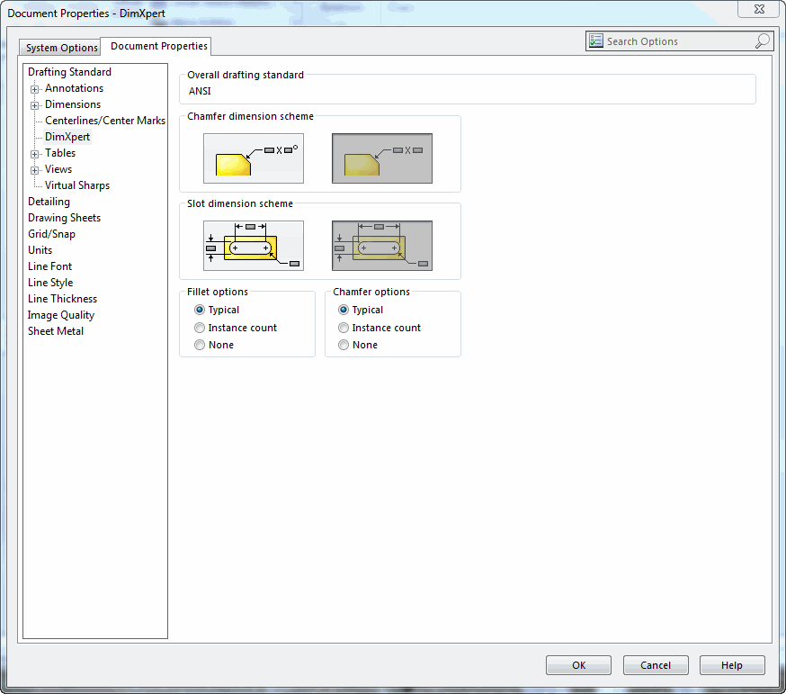

Document Properties > DimXpert
Setting
Get/Set Methods
Return Value or <Value>
Comments
Chamfer dimension scheme
IModelDocExtension::GetUserPreferenceInteger(swUserPreferenceIntegerValue_e.swDetailingDimXpertChamferScheme, swUserPreferenceOption_e.swDetailingNoOptionSpecified)
IModelDocExtension::SetUserPreferenceInteger(swUserPreferenceIntegerValue_e.swDetailingDimXpertChamferScheme, swUserPreferenceOption_e.swDetailingNoOptionSpecified, swDetailingDimXpertChamferStyle_e.<Value>)
See swDetailingDimXpertChamferStyle_e for valid options
Specifies chamfer dimension scheme
Slot dimension scheme
IModelDocExtension::GetUserPreferenceInteger(swUserPreferenceIntegerValue_e.swDetailingDimXpertSlotScheme, swUserPreferenceOption_e.swDetailingNoOptionSpecified)
IModelDocExtension::SetUserPreferenceInteger(swUserPreferenceIntegerValue_e.swDetailingDimXpertSlotScheme, swUserPreferenceOption_e.swDetailingNoOptionSpecified, swDetailingDimXpertSlotStyle_e.<Value>)
See swDetailingDimXpertSlotStyle_e for valid options
Specifies slot dimension scheme
Fillet options
IModelDocExtension::GetUserPreferenceInteger(swUserPreferenceIntegerValue_e.swDetailingDimXpertFilletOptions, swUserPreferenceOption_e.swDetailingNoOptionSpecified)
IModelDocExtension::SetUserPreferenceInteger(swUserPreferenceIntegerValue_e.swDetailingDimXpertFilletOptions, swUserPreferenceOption_e.swDetailingNoOptionSpecified, swDetailingDimXpertFilletInstanceStyle_e.<Value>)
See swDetailingDimXpertFilletInstanceStyle_e for valid options
Specifies fillet options
Chamfer options
IModelDocExtension::GetUserPreferenceInteger(swUserPreferenceIntegerValue_e.swDetailingDimXpertChamferOptions, swUserPreferenceOption_e.swDetailingNoOptionSpecified)
IModelDocExtension::SetUserPreferenceInteger(swUserPreferenceIntegerValue_e.swDetailingDimXpertChamferOptions, swUserPreferenceOption_e.swDetailingNoOptionSpecified, swDetailingDimXpertChamferInstanceStyle_e.<Value>)
See swDetailingDimXpertChamferInstanceStyle_e for valid options
Specifies chamfer options
