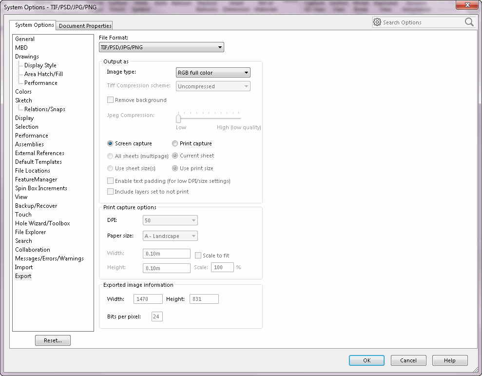

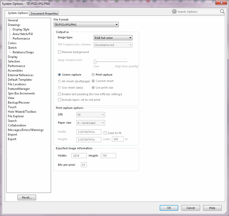

System Options > Export > TIF/PSD/JPG/PNG
To display the dialog:
Click Tools > Options > System Options > Export > TIF/PSD/JPG/PNG in File Format.
- or -
  1. Click File > Save As.
  2. In Save as type, select Tif, Adobe PhotoShop Files, JPEG, or Portable Network Graphics.
  3. Click Options.
