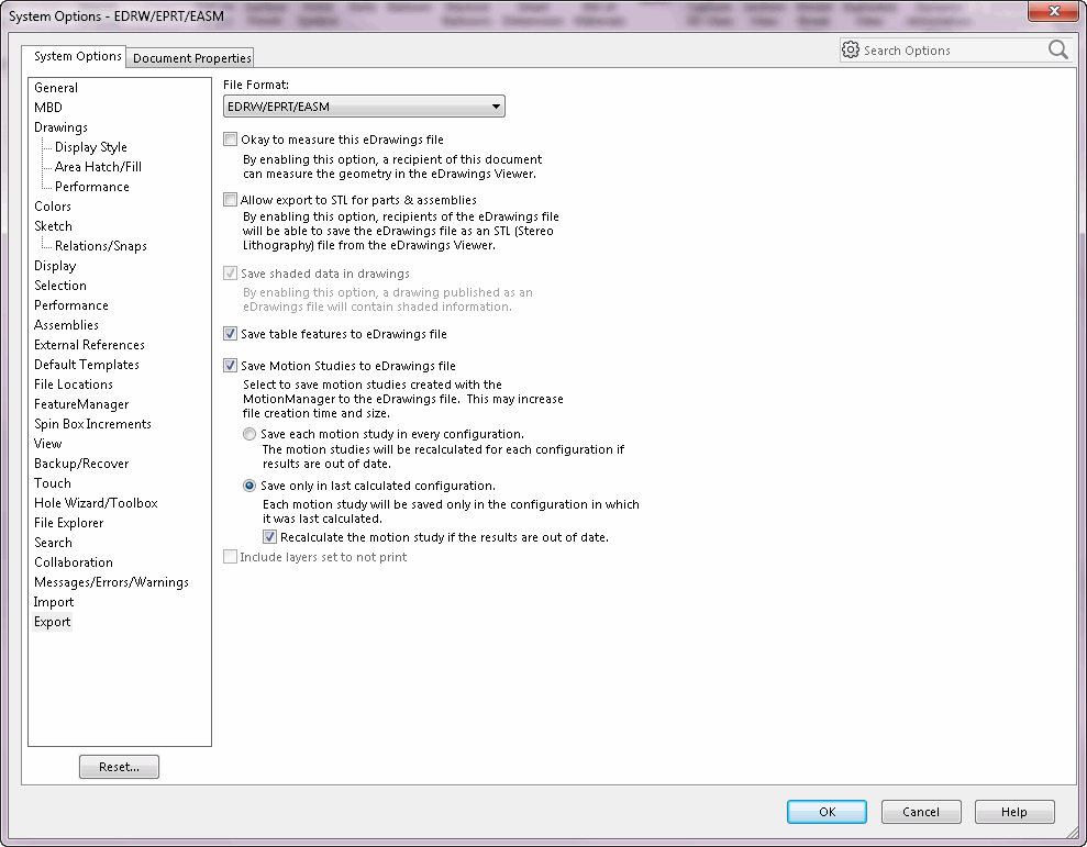

System Options > Export > EDRW/EPRT/EASM
This topic contains two tables. The information in the table:
  • appearing immediately after the screen capture corresponds to the settings on that dialog.
  • titled Obsolete Enumerators contains enumerators that previously appeared on the dialog but are now obsolete.
To display the dialog:
Click Tools > Options > System Options > Export > EDRW/EPRT/EASM in File Format.
- or -
  1. Click File > Save As.
  2. In Save as type, select eDrawings.
  3. Click Options.
Setting
Get/Set Methods
Return Value
or
<OnFlag>
Comment
Okay to measure this eDrawings file
ISldWorks::GetUserPreferenceToggle(swUserPreferenceToggle_e.swEDrawingsOkayToMeasure)
ISldWorks::SetUserPreferenceToggle(swUserPreferenceToggle_e.swEDrawingsOkayToMeasure, <OnFlag>)
Boolean value
Specifies whether to enable measurement of geometry in eDrawings file
Allow export to STL for parts & assemblies
ISldWorks::GetUserPreferenceToggle(swUserPreferenceToggle_e.swEDrawingsExportSTLOkay)
ISldWorks::SetUserPreferenceToggle(swUserPreferenceToggle_e.swEDrawingsExportSTLOkay, <OnFlag>)
Boolean value
Specifies whether to allow recipients of eDrawings file to save it as STL file from eDrawings Viewer
Save shaded data in drawings
ISldWorks::GetUserPreferenceToggle(swUserPreferenceToggle_e.swEDrawingsSaveShadedDataInDrawings)
ISldWorks::SetUserPreferenceToggle(swUserPreferenceToggle_e.swEDrawingsSaveShadedDataInDrawings, <OnFlag>)
Boolean value
For SOLIDWORKS drawings only; specifies whether to save shaded data from SOLIDWORKS drawing document in published eDrawings file
Save Bill of Materials features to eDrawings file
ISldWorks::GetUserPreferenceToggle(swUserPreferenceToggle_e.swEDrawingsSaveBOM)
ISldWorks::SetUserPreferenceToggle(swUserPreferenceToggle_e.swEDrawingsSaveBOM, <OnFlag>)
Boolean value
Specifies whether to save BOM in eDrawings file
Save Motion Studies to eDrawings file
ISldWorks::GetUserPreferenceToggle(swUserPreferenceToggle_e.swEDrawingsSaveAnimationOkay)
ISldWorks::SetUserPreferenceToggle(swUserPreferenceToggle_e.swEDrawingsSaveAnimationOkay, <OnFlag>)
Boolean value
Specifies whether to save motion studies to eDrawings file
Save each motion study in every configuration
and
Save only in last calculated configuration
ISldWorks::GetUserPreferenceToggle(swUserPreferenceToggle_e.swEDrawingsSaveAnimationToAllConfigs)
ISldWorks::SetUserPreferenceToggle(swUserPreferenceToggle_e.swEDrawingsSaveAnimationToAllConfigs, <OnFlag>)
Boolean value:
  • True: Save each motion study in every configuration
  • False: save each motion study only in the configuration in which it was last calculated
Specifies how to save motion studies to eDrawings files
Recalculate the motion study if the results are out of date
ISldWorks::GetUserPreferenceToggle(swUserPreferenceToggle_e.swEDrawingsSaveAnimationRecalculate)
ISldWorks::SetUserPreferenceToggle(swUserPreferenceToggle_e.swEDrawingsSaveAnimationRecalculate, <OnFlag>)
Boolean value
Specifies whether to recalculate the motion study or use existing results in eDrawings file
Include layers set not to print
ISldWorks::GetUserPreferenceToggle(swUserPreferenceToggle_e.swEDrawingsIncludeLayersNotToPrint)
ISldWorks::SetUserPreferenceToggle(swUserPreferenceToggle_e.swEDrawingsIncludeLayersNotToPrint, <OnFlag>)
Boolean value
Specifies whether to include layers set not to print
Enumerator
Comment
swEDrawingsCompression
Obsolete
swEdrawingsSaveAsSelectionOption
Obsolete
swEmodelSelectionList
Obsolete
