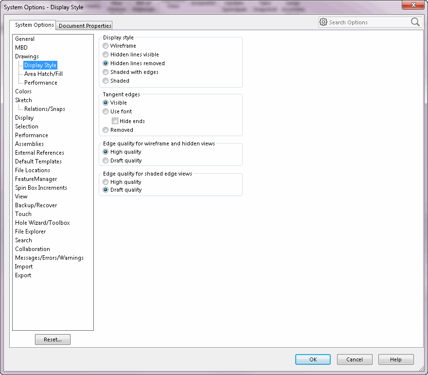

This topic contains two tables. The information in the table:
  • appearing immediately after the screen capture of the dialog corresponds to the settings on that dialog.
  • titled Obsolete Enumerators contains enumerators that previously appeared on the dialog but are now obsolete.
Setting
Get/Set Methods
Return Value
or
<Value>
or
<OnFlag>
Comment
Display style - Wireframe
ISldWorks::GetUserPreferenceIntegerValue(swUserPreferenceIntegerValue_e.swHiddenEdgeDisplayDefault)
ISldWorks::SetUserPreferenceIntegerValue(swUserPreferenceIntegerValue_e.swHiddenEdgeDisplayDefault, <swDisplayMode_e.swWIREFRAME)
See swDisplayMode_e for valid options
Display style - Hidden lines visible
ISldWorks::SetUserPreferenceIntegerValue(swUserPreferenceIntegerValue_e.swHiddenEdgeDisplayDefault, <swDisplayMode_e.swHIDDEN_GREYED)
Display style - Hidden lines removed
ISldWorks::SetUserPreferenceIntegerValue(swUserPreferenceIntegerValue_e.swHiddenEdgeDisplayDefault, <swDisplayMode_e.swHIDDEN)
Display style - Shaded with edges
ISldWorks::SetUserPreferenceIntegerValue(swUserPreferenceIntegerValue_e.swHiddenEdgeDisplayDefault, <swDisplayMode_e.swSHADED)
To display a drawing view shaded with edges, also set ISldWorks::SetUserPreferenceToggle(swUserPreferenceToggle_e.swDrawingsDefaultDisplayTypeHLREdgesWhenShaded, True)
ISldWorks::GetUserPreferenceToggle(swUserPreferenceToggle_e.swDrawingsDefaultDisplayTypeHLREdgesWhenShaded)
ISldWorks::SetUserPreferenceToggle(swUserPreferenceToggle_e.swDrawingsDefaultDisplayTypeHLREdgesWhenShaded, <OnFlag>)
Boolean value
Tangent edges - Visible
ISldWorks::GetUserPreferenceIntegerValue(swUserPreferenceIntegerValue_e.swTangentEdgeDisplayDefault)
ISldWorks::SetUserPreferenceIntegerValue(swUserPreferenceIntegerValue_e.swTangentEdgeDisplayDefault, <swDisplayTangentEdges_e.swTangentEdgesVisible)
See swDisplayTangentEdges_e for valid options
Specifies tangent edges using a solid line
Tangent edges - Use font
ISldWorks::SetUserPreferenceIntegerValue(swUserPreferenceIntegerValue_e.swTangentEdgeDisplayDefault, <swDisplayTangentEdges_e.swTangentEdgesVisibleAndFonted)
Specifies tangent edges using a line in the default font
Tangent edges - Hide ends
ISldWorks::GetUserPreferenceToggle(swUserPreferenceToggle_e.swDrawingHideEnds)
ISldWorks::SetUserPreferenceToggle(swUserPreferenceToggle_e.swDrawingHideEnds, <OnFlag>)
Boolean value
Specifies whether to hide the start and end segments of tangent edges
Tangent edges - Removed
ISldWorks::SetUserPreferenceIntegerValue(swUserPreferenceIntegerValue_e.swTangentEdgeDisplayDefault, <swDisplayTangentEdges_e.swTangentEdgesHidden)
Specifies to not display tangent edges
Edge quality for wireframe and hidden views - High/Draft  quality
ISldWorks::GetUserPreferenceToggle(swUserPreferenceToggle_e.swEdgeQualityWireframeHiddenViews)
ISldWorks::SetUserPreferenceToggle(swUserPreferenceToggle_e.swEdgeQualityWireframeHiddenViews, False)
Boolean value
True for high edge quality for wireframe and hidden views; false for draft edge quality
Edge quality for shaded edge views - High/Draft quality
ISldWorks::GetUserPreferenceToggle(swUserPreferenceToggle_e.swEdgeQualityShadedEdgeViews)
ISldWorks::SetUserPreferenceToggle(swUserPreferenceToggle_e.swEdgeQualityShadedEdgeViews, True)
Boolean value
True for high edge quality for shaded edge views; false for draft edge quality
Enumerator
Comment
swDrawingsDefaultDisplayTypeFastHLRHLV
Obsolete; specified the display quality for new drawing views
