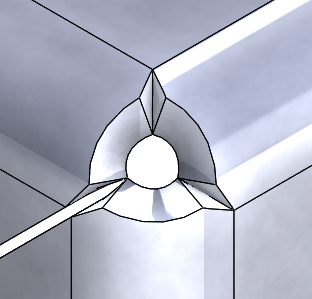

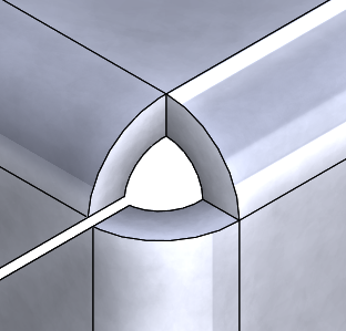

Corner Relief Display
Three bend corners are improved to create corner reliefs that are smaller than the required default corner treatment when in the folded state.
Previously, the software could only create three bend corner reliefs in the folded part when the corner treatment was bigger than the necessary cutout that was required to unfold the part.
The following shows a circular corner relief in the folded state.
SOLIDWORKS 2018 SOLIDWORKS 2017
