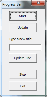

// 4. Modify Form1.cs [Design] to look like this:

// 1. Shows a dialog box.
// 2. Click Start.
//    * Displays a progress indicator on the SOLIDWORKS icon on the
//      system taskbar.
//    * Increments the progress indicator to 100% completion.
// 3. Click Update repeatedly to increment the progress indicator in steps of
//    10.
// 4. Inspect the Immediate window to see the return code after each update.
// 5. Type a new title and click Update Title to change the progress indicator
//    title.
// 6. Click Stop to remove the progress indicator from SOLIDWORKS.
// 7. Click Exit to close the dialog box.
