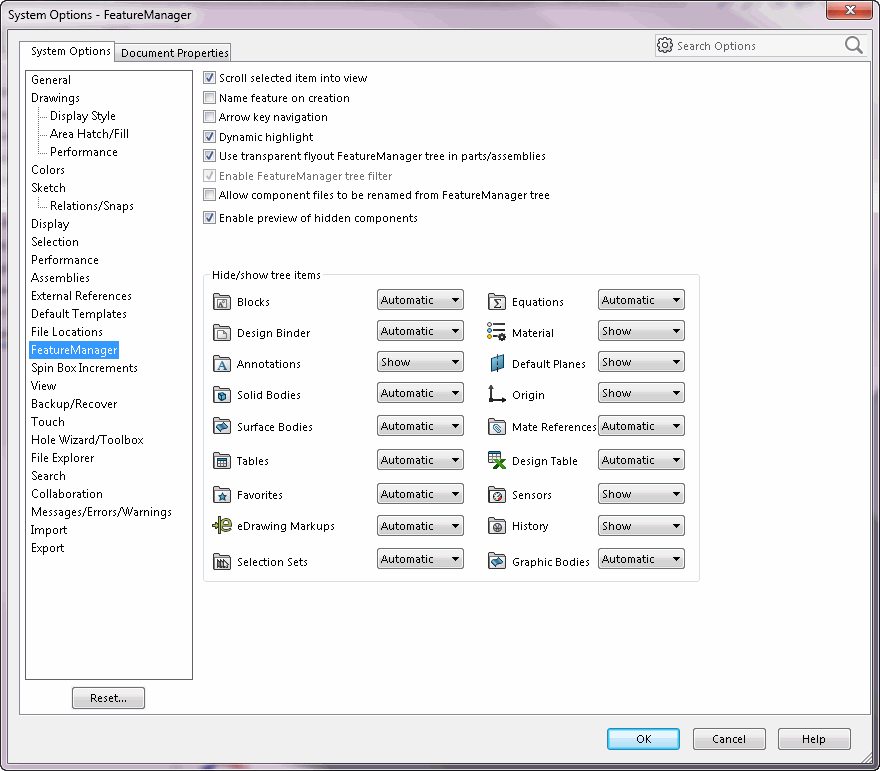

System Options > FeatureManager
Setting
Get/Set Methods
Return Value
or
<Value>
or
<OnFlag>
Comment
Scroll selected item into view
ISldWorks::GetUserPreferenceToggle(swUserPreferenceToggle_e.swFeatureManagerEnsureVisible)
ISldWorks::SetUserPreferenceToggle(swUserPreferenceToggle_e.swFeatureManagerEnsureVisible, <OnFlag>)
Boolean value
Specifies whether FeatureManager design tree should automatically scroll to display feature icon related to selected items in graphics area
Name feature on creation
ISldWorks::GetUserPreferenceToggle(swUserPreferenceToggle_e.swFeatureManagerNameFeatureWhenCreated)
ISldWorks::SetUserPreferenceToggle(swUserPreferenceToggle_e.swFeatureManagerNameFeatureWhenCreated, <OnFlag>)
Boolean value
Specifies to automatically select new feature in FeatureManager design tree to name it
Arrow key navigation
ISldWorks::GetUserPreferenceToggle(swUserPreferenceToggle_e.swFeatureManagerKeyboardNavigation)
ISldWorks::SetUserPreferenceToggle(swUserPreferenceToggle_e.swFeatureManagerKeyboardNavigation, <OnFlag>)
Boolean value
Specifies whether arrow keys can be used to traverse FeatureManager design tree, and expand or collapse design tree and its contents
Dynamic highlight
ISldWorks::GetUserPreferenceToggle(swUserPreferenceToggle_e.swFeatureManagerDynamicHighlight)
ISldWorks::SetUserPreferenceToggle(swUserPreferenceToggle_e.swFeatureManagerDynamicHighlight, <OnFlag>)
Boolean value
Specifies whether geometry in graphics area is highlighted when pointer passes over item in FeatureManager design tree
Use transparent flyout FeatureManager tree in parts/assemblies
ISldWorks::GetUserPreferenceToggle(swUserPreferenceToggle_e.swFeatureManagerTransparentFlyout)
ISldWorks::SetUserPreferenceToggle(swUserPreferenceToggle_e.swFeatureManagerTransparentFlyout, <OnFlag>)
Boolean value
Specifies whether to use transparent flyout FeatureManager in part and assembly documents
Enable FeatureManager tree filter
SldWorks::GetUserPreferenceToggle(swUserPreferenceToggle_e.swFeatureManagerEnableTreeFilter)
ISldWorks::SetUserPreferenceToggle(swUserPreferenceToggle_e.swFeatureManagerEnableTreeFilter, <OnFlag>)
Boolean value
Specifies whether to display the FeatureManager design tree filter
Unlike the user interface, you can turn this setting on or off when a model document is open
Allow component files to be renamed from FeatureManager tree
SldWorks::GetUserPreferenceToggle(swUserPreferenceToggle_e.swFeatureManagerEnableRenamingComponent)
ISldWorks::SetUserPreferenceToggle(swUserPreferenceToggle_e.swFeatureManagerEnableRenamingComponent, <OnFlag>)
Boolean value
Specifies whether to enable renaming components
Enable preview of hidden components
SldWorks::GetUserPreferenceToggle(swUserPreferenceToggle_e.swFeatureManagerEnablePreviewHiddenComponents)
ISldWorks::SetUserPreferenceToggle(swUserPreferenceToggle_e.swFeatureManagerEnablePreviewHiddenComponents, <OnFlag>)
Boolean value
Specifies whether to enable preview of hidden components
Hide/show tree items - Blocks
ISldWorks::GetUserPreferenceIntegerValue(swUserPreferenceIntegerValue_e.swFeatureManagerBlocksVisibility)
ISldWorks::SetUserPreferenceIntegerValue(swUserPreferenceIntegerValue_e.swFeatureManagerBlocksVisibility, swAutoHideShowResponse_e.<Value>)
See swAutoHideShowResponse_e for valid options
Hide/show tree items - Design Binder
ISldWorks::GetUserPreferenceIntegerValue(swUserPreferenceIntegerValue_e.swFeatureManagerDesignBinderVisibility)
ISldWorks::SetUserPreferenceIntegerValue(swUserPreferenceIntegerValue_e.swFeatureManagerDesignBinderVisibility, swAutoHideShowResponse_e.<Value>)
Hide/show tree items - Annotations
ISldWorks::GetUserPreferenceIntegerValue(swUserPreferenceIntegerValue_e.swFeatureManagerAnnotationsVisibility)
ISldWorks::SetUserPreferenceIntegerValue(swUserPreferenceIntegerValue_e.swFeatureManagerAnnotationsVisibility, swAutoHideShowResponse_e.<Value>)
Hide/show tree items - Solid Bodies
ISldWorks::GetUserPreferenceIntegerValue(swUserPreferenceIntegerValue_e.swFeatureManagerSolidBodiesVisibility)
ISldWorks::SetUserPreferenceIntegerValue(swUserPreferenceIntegerValue_e.swFeatureManagerSolidBodiesVisibility, swAutoHideShowResponse_e.<Value>)
Hide/show tree items - Surface Bodies
ISldWorks::GetUserPreferenceIntegerValue(swUserPreferenceIntegerValue_e.swFeatureManagerSurfaceBodiesVisibility)
ISldWorks::SetUserPreferenceIntegerValue(swUserPreferenceIntegerValue_e.swFeatureManagerSurfaceBodiesVisibility, swAutoHideShowResponse_e.<Value>)
Hide/show tree items - Tables
ISldWorks::GetUserPreferenceIntegerValue(swUserPreferenceIntegerValue_e.swFeatureManagerTableFolderVisibility)
ISldWorks::SetUserPreferenceIntegerValue(swUserPreferenceIntegerValue_e.swFeatureManagerTableFolderVisibility, swAutoHideShowResponse_e.<Value>)
Hide/show tree items - Favorites
ISldWorks::GetUserPreferenceIntegerValue(swUserPreferenceIntegerValue_e.swFeatureManagerFavorites)
ISldWorks::SetUserPreferenceIntegerValue(swUserPreferenceIntegerValue_e.swFeatureManagerFavorites, swAutoHideShowResponse_e.<Value>)
Hide/show tree items - eDrawing Markups
ISldWorks::GetUserPreferenceIntegerValue(swUserPreferenceIntegerValue_e.swFeatureManagerEDrawingMarkups)
ISldWorks::SetUserPreferenceIntegerValue(swUserPreferenceIntegerValue_e.swFeatureManagerEDrawingMarkups, swAutoHideShowResponse_e.<Value>)
Hide/show tree items - Selection Sets
ISldWorks::GetUserPreferenceIntegerValue(swUserPreferenceIntegerValue_e.swFeatureManagerSelectionSetsVisibility)
ISldWorks::SetUserPreferenceIntegerValue(swUserPreferenceIntegerValue_e.swFeatureManagerSelectionSetsVisibility, swAutoHideShowResponse_e.<Value>)
Hide/show tree items - Equations
ISldWorks::GetUserPreferenceIntegerValue(swUserPreferenceIntegerValue_e.swFeatureManagerEquationsVisibility)
ISldWorks::SetUserPreferenceIntegerValue(swUserPreferenceIntegerValue_e.swFeatureManagerEquationsVisibility, swAutoHideShowResponse_e.<Value>)
Hide/show tree items - Material
ISldWorks::GetUserPreferenceIntegerValue(swUserPreferenceIntegerValue_e.swFeatureManagerMaterialVisibility)
ISldWorks::SetUserPreferenceIntegerValue(swUserPreferenceIntegerValue_e.swFeatureManagerMaterialVisibility, swAutoHideShowResponse_e.<Value>)
Hide/show tree items - Default Planes
ISldWorks::GetUserPreferenceIntegerValue(swUserPreferenceIntegerValue_e.swFeatureManagerDefaultPlanesVisibility)
ISldWorks::SetUserPreferenceIntegerValue(swUserPreferenceIntegerValue_e.swFeatureManagerDefaultPlanesVisibility, swAutoHideShowResponse_e.<Value>)
Hide/show tree items - Origin
ISldWorks::GetUserPreferenceIntegerValue(swUserPreferenceIntegerValue_e.swFeatureManagerOriginVisibility)
ISldWorks::SetUserPreferenceIntegerValue(swUserPreferenceIntegerValue_e.swFeatureManagerOriginVisibility, swAutoHideShowResponse_e.<Value>)
Hide/show tree items - Mate References
ISldWorks::GetUserPreferenceIntegerValue(swUserPreferenceIntegerValue_e.swFeatureManagerMateReferencesVisibility)
ISldWorks::SetUserPreferenceIntegerValue(swUserPreferenceIntegerValue_e.swFeatureManagerMateReferencesVisibility, swAutoHideShowResponse_e.<Value>)
Hide/show tree items - Design Table
ISldWorks::GetUserPreferenceIntegerValue(swUserPreferenceIntegerValue_e.swFeatureManagerDesignTableVisibility)
ISldWorks::SetUserPreferenceIntegerValue(swUserPreferenceIntegerValue_e.swFeatureManagerDesignTableVisibility, swAutoHideShowResponse_e.<Value>)
Hide/show tree items - Sensors
ISldWorks::GetUserPreferenceIntegerValue(swUserPreferenceIntegerValue_e.swFeatureManagerSensorVisibility)
ISldWorks::SetUserPreferenceIntegerValue(swUserPreferenceIntegerValue_e.swFeatureManagerSensorVisibility, swAutoHideShowResponse_e.<Value>)
Hide/show tree items - History
ISldWorks::GetUserPreferenceIntegerValue(swUserPreferenceIntegerValue_e.swFeatureManagerHistory)
ISldWorks::SetUserPreferenceIntegerValue(swUserPreferenceIntegerValue_e.swFeatureManagerHistory, swAutoHideShowResponse_e.<Value>)
Hide/show tree items - Graphic Bodies
ISldWorks::GetUserPreferenceIntegerValue(swUserPreferenceIntegerValue_e.swFeatureManagerMeshBodiesVisibility)
ISldWorks::SetUserPreferenceIntegerValue(swUserPreferenceIntegerValue_e.swFeatureManagerMeshBodiesVisibility, swAutoHideShowResponse_e.<Value>)
