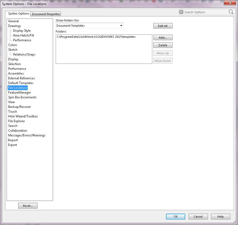

System Options > File Locations
This topic contains two tables. The information in the table:
  • appearing immediately after the screen capture of the dialog corresponds to the settings on that dialog.
  • titled Obsolete Enumerators contains enumerators that previously appeared on the dialog but are now obsolete.

ISldWorks::GetUserPreferenceStringValue(swUserPreferenceStringValue_e.swFileLocationsSustainabilityReportTemplateFolder)
ISldWorks::SetUserPreferenceStringValue(swUserPreferenceStringValue_e.swFileLocationsSustainabilityReportTemplateFolder, <Value>)
String value
Show folders for - Costing Report Template Folder
ISldWorks::GetUserPreferenceStringValue(swUserPreferenceStringValue_e.swFileLocationsCostingReportTemplateFolder)
ISldWorks::SetUserPreferenceStringValue(swUserPreferenceStringValue_e.swFileLocationsCostingReportTemplateFolder, <Value>)
String value
Show folders for - Costing templates
ISldWorks::GetUserPreferenceStringValue(swUserPreferenceStringValue_e.swFileLocationsCostingTemplates)
ISldWorks::SetUserPreferenceStringValue(swUserPreferenceStringValue_e.swFileLocationsCostingTemplates, <Value>)
String value
Show folders for - Weld Table Template
ISldWorks::GetUserPreferenceStringValue(swUserPreferenceStringValue_e.swFileLocationsWeldTableTemplate)
ISldWorks::SetUserPreferenceStringValue(swUserPreferenceStringValue_e.swFileLocationsWeldTableTemplate, <Value>)
String value
Show folders for - Bend Table Template
ISldWorks::GetUserPreferenceStringValue(swUserPreferenceStringValue_e.swFileLocationsBendTableTemplate)
ISldWorks::SetUserPreferenceStringValue(swUserPreferenceStringValue_e.swFileLocationsBendTableTemplate, <Value>)
String value
Show folders for - Punch Table Template
ISldWorks::GetUserPreferenceStringValue(swUserPreferenceStringValue_e.swFileLocationsPunchTableTemplate)
ISldWorks::SetUserPreferenceStringValue(swUserPreferenceStringValue_e.swFileLocationsPunchTableTemplate, <Value>)
String value
Enumerator
Comment
swFileLocationsAppearances
Obsolete
swFileLocationsJournalFile
Obsolete
swFileLocationsLibraryFeatures
Obsolete; use swFileLocationsDesignLibrary
swFleLocationsLights
Obsolete
swFileLocationsPaletteAssemblies
swFileLocationsPaletteFeatures
swFileLocationsPaletteFormTools
swFileLocationsPaletteParts
swFileLocationsScenes
Obsolete
swFileLocationsDesignCheckerFile
Obsolete
