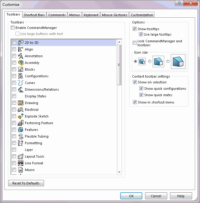

Tools > Customize > Toolbars
This topic contains two tables. The information in the table:
  • appearing immediately after the screen capture of the dialog corresponds to the settings on that dialog.
  • titled Obsolete Enumerators contains enumerators that previously appeared on the dialog but are now obsolete.
Setting
Get/Set Methods
Return Value or <Value> or <OnFlag>
Comments
Options - Icon size
ISldWorks::GetUserPreferenceIntegerValue(swUserPreferenceIntegerValue_e.swButtonSize)
ISldWorks::SetUserPreferenceIntegerValue(swUserPreferenceIntegerValue_e.swButtonSize, swButtonSize_e.<Value>)
See swButtonSize_e for valid options
