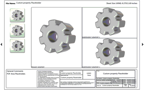

    In the lower list, information about the selected template appears, such as number of pages, orientation, and number of viewports. A large preview of the selected template is displayed, including previews of each page for multipage templates. For example:
    In multipage templates, click Next and Back beside the preview to move between pages.
