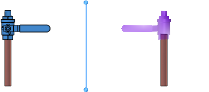

    Orient Component Option Image of Mirrored Component
    X mirrored, Y mirrored
    X and Y axes mirror about the plane.
    X mirrored and flipped, Y mirrored
    X and Y axes mirror about the plane with the X-axis direction reversed.
    X mirrored, Y mirrored and flipped
    X and Y axes mirror about the plane with the Y-axis direction reversed.
    X mirrored and flipped, Y mirrored and flipped
    X and Y axes mirror about the plane with the X and Y axes direction reversed.
