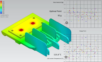

Boundary conditions depend on coordinates, time, and monitor parameters, such as goals. You can define sophisticated dependencies using conditional and Boolean expressions such as IF, AND, OR, XOR, NOT, >, <, and =.
For example, you can set the value of a heat source dependent on two different temperature sensors, defined as temperature goals, so that the dissipated power is downgraded depending on the temperature at the sensors.
