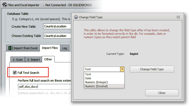

  • You can do full text searches of imported files. In the Files and Excel Importer tool, specify the Full Text Search option.
  • You can change the data type (Text, Date, or Number) of a link to a third-party field. The software warns you that it deletes incompatible data. Previously, to change the data type, you had to delete and create the field again.
