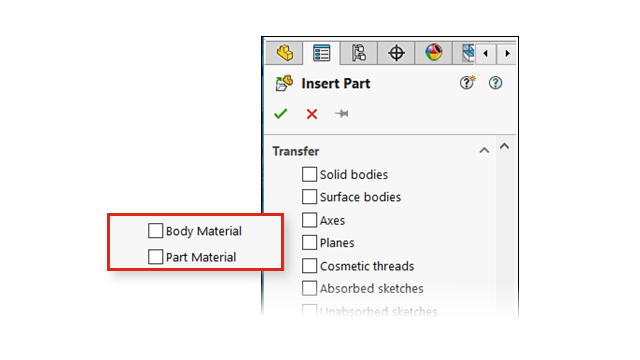

Transfer Body Material or Part Material
You can transfer body material or part material when you insert or a part, a derived component part, or a mirrored component part.
Previously, the Insert Part PropertyManager provided only Material as an option for transferring material. For mirror legacy files, material properties are mapped to Body Material.
