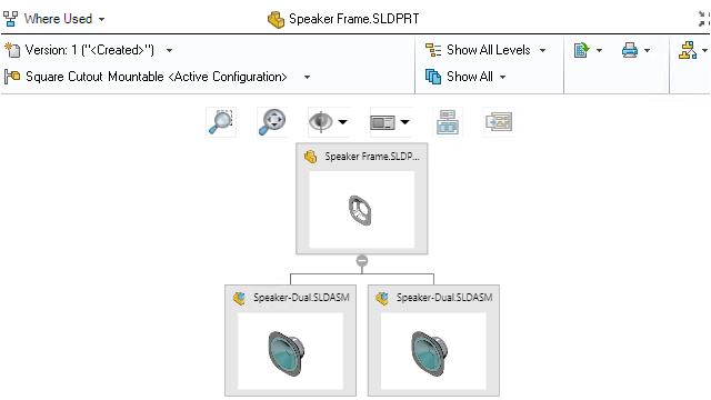

Treehouse View in the Where Used Tab
SOLIDWORKS PDM 2021 extends Treehouse view in the Contains tab to the Where Used tab. This helps you to view all the parent relationships of the selected child in a hierarchical and graphical format.
Available in SOLIDWORKS PDM Professional only.
