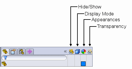

  1. Click at the top of the FeatureManager pane (to the right of the tabs) to expand the Display Pane.
The Display Pane appears to the right of the FeatureManager pane. It has four columns:
  1. Click to collapse the Display Pane.
