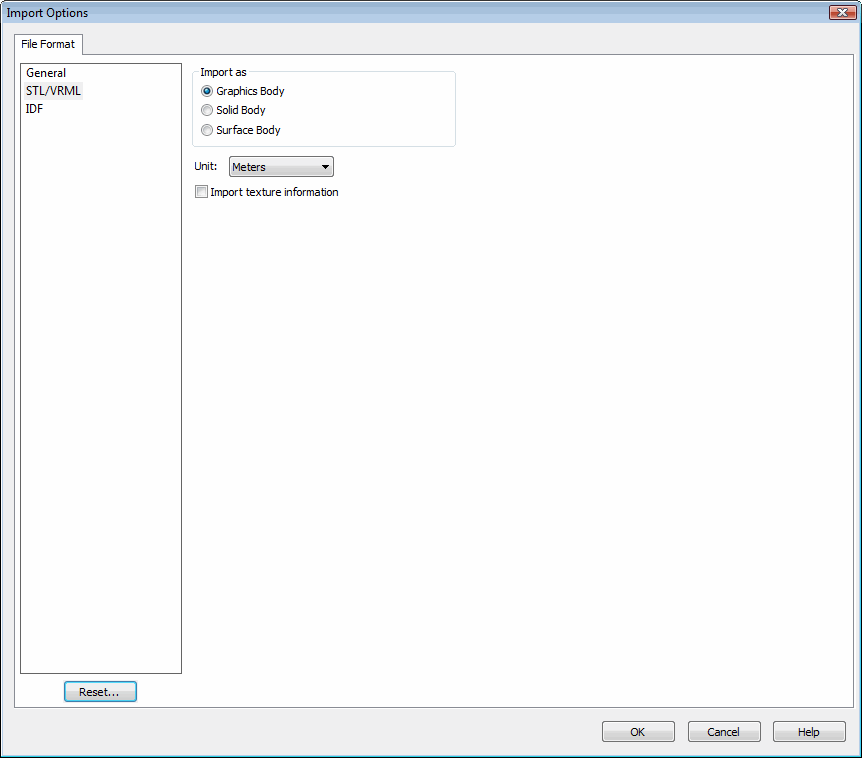

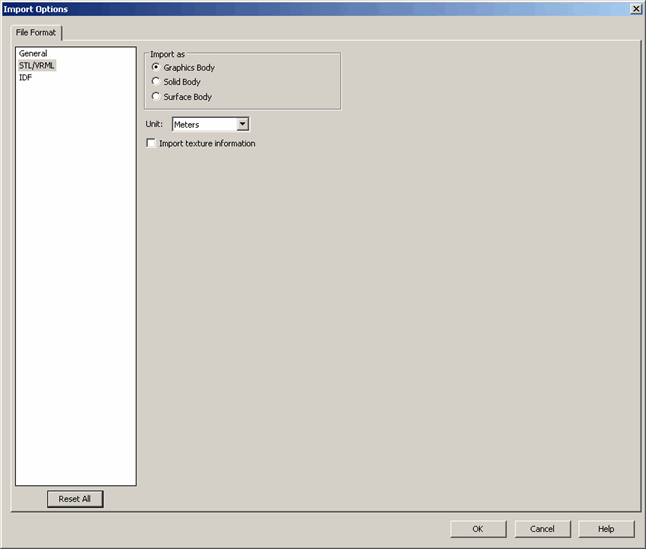

File > Open > Files of type > type of file > Options > STL/VRML
The Import Options - File Format - STL/VRML dialog is displayed when you click the Options button after selecting one of the following types of files in Files of type in the Open dialog:
  • STL
  • VRML
Setting
Get/Set Methods
Return Value
or
<Value>
or
<OnFlag>
Comment
Import as - Graphics body
ISldWorks::GetUserPreferenceIntegerValue(swUserPerferenceIntegerValue_e.swImportStlVrmlModelType) ISldWorks::SetUserPreferenceIntegerValue(swUserPerferenceIntegerValue_e.swImportStlVrmlModelType, swImportStlVrmlModelType_e.swImportStlVrmlModelType_Graphics)
Import as - Solid body
ISldWorks::GetUserPreferenceIntegerValue(swUserPerferenceIntegerValue_e.swImportStlVrmlModelType) ISldWorks::SetUserPreferenceIntegerValue(swUserPerferenceIntegerValue_e.swImportStlVrmlModelType, swImportStlVrmlModelType_e.swImportStlVrmlModelType_Solid)
Import as - Surface body
ISldWorks::GetUserPreferenceIntegerValue(swUserPerferenceIntegerValue_e.swImportStlVrmlModelType) ISldWorks::SetUserPreferenceIntegerValue(swUserPerferenceIntegerValue_e.swImportStlVrmlModelType, swImportStlVrmlModelType_e.swImportStlVrmlModelType_Surface)
Unit
ISldWorks::GetUserPreferenceIntegerValue(swUserPerferenceIntegerValue_e.swImportStlVrmlModelType) ISldWorks::SetUserPreferenceIntegerValue(swUserPerferenceIntegerValue_e.swImportStlVrmlModelType, swLengthUnit_e.<Value>)
Valid options from swLengthUnit_e:
  • 0 = swMM (millimeters)
  • 1 = swCM (centimeters)
  • 2 = swMETER
  • 3 = swINCHES
  • 4 = swFEET
Import texture information
ISldWorks::GetUserPreferenceToggle(swUserPreferenceToggle_e.swImportStlVrmlTextureInformation)
ISldWorks::SetUserPreferenceToggle(swUserPreferenceToggle_e.swImportStlVrmlTextureInformation, <OnFlag>)
Boolean value
