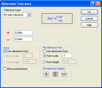

Document Properties > Dimensions  > Dimension Tolerance
The Dimension Tolerance dialog appears when the Tolerance button is clicked on the following document property pages:
Document Properties page

Substitute <UserPrefOption> in the methods below to get and set the dimension tolerance settings for a given dimension document property:
Setting
Get/Set Methods
Return Value or <Value>
Comments
Tolerance type
IModelDocExtension::GetUserPreferenceInteger(swUserPreferenceIntegerValue_e.swDetailingToleranceStyle, swUserPreferenceOption_e.<UserPrefOption>)
IModelDocExtension::SetUserPreferenceInteger(swUserPreferenceIntegerValue_e.swDetailingToleranceStyle, swUserPreferenceOption_e.<UserPrefOption>, swTolType_e.<Value>)
See swTolType_e for valid options
Maximum tolerance value
IModelDocExtension::GetUserPreferenceDouble(swUserPreferenceDoubleValue_e.swDetailingMaxToleranceValue, swUserPreferenceOption_e.<UserPrefOption>)
IModelDocExtension::SetUserPreferenceDouble(swUserPreferenceDoubleValue_e.swDetailingMaxToleranceValue, swUserPreferenceOption_e.<UserPrefOption>, <Value>)
Double value
Specifies the maximum tolerance for dimensions in a drawing document
Minimum tolerance value
IModelDocExtension::GetUserPreferenceDouble(swUserPreferenceDoubleValue_e.swDetailingMinToleranceValue, swUserPreferenceOption_e.<UserPrefOption>)
IModelDocExtension::SetUserPreferenceDouble(swUserPreferenceDoubleValue_e.swDetailingMinToleranceValue, swUserPreferenceOption_e.<UserPrefOption>, <Value>)
Double value
Specifies the minimum tolerance for dimensions in a drawing document
Font - Use dimension font
IModelDocExtension::GetUserPreferenceToggle(swUserPreferenceToggle_e.swDetailingDimensionsToleranceUseDimensionFont, swUserPreferenceOption_e.<UserPrefOption>)
IModelDocExtension::SetUserPreferenceToggle(swUserPreferenceToggle_e.swDetailingDimensionsToleranceUseDimensionFont, swUserPreferenceOption_e.<UserPrefOption>, <Value>)
Boolean value
Specifies whether to change font size for dimension tolerance text
Font - Size by scale or height
IModelDocExtension::GetUserPreferenceInteger(swUserPreferenceIntegerValue_e.swDetailingToleranceTextSizing, swUserPreferenceOption_e.<UserPrefOption>)
IModelDocExtension::SetUserPreferenceInteger(swUserPreferenceIntegerValue_e.swDetailingToleranceTextSizing, swUserPreferenceOption_e.<UserPrefOption>, swDetailingToleranceTextSizing_e.<Value>)
See swDetailingToleranceTextSizing_e for valid options; depending on the option chosen, also set either font scale value or font height value
Specifies how to size the tolerance text
Font - Font scale value
IModelDocExtension::GetUserPreferenceDouble(swUserPreferenceDoubleValue_e.swDetailingToleranceTextScale, swUserPreferenceOption_e.<UserPrefOption>)
IModelDocExtension::SetUserPreferenceDouble(swUserPreferenceDoubleValue_e.swDetailingToleranceTextScale, swUserPreferenceOption_e.<UserPrefOption>, <Value>)
Double value (0 - 10.0)
Specifies value to scale tolerance font
Font - Font height value
IModelDocExtension::GetUserPreferenceDouble(swUserPreferenceDoubleValue_e.swDetailingToleranceTextHeight, swUserPreferenceOption_e.<UserPrefOption>)
IModelDocExtension::SetUserPreferenceDouble(swUserPreferenceDoubleValue_e.swDetailingToleranceTextHeight, swUserPreferenceOption_e.<UserPrefOption>, <Value>)
Double value in meters
Specifies height of tolerance font
Fit tolerance font - Use dimension font
IModelDocExtension::GetUserPreferenceToggle(swUserPreferenceToggle_e.swDetailingDimensionsToleranceFitToUseDimensionFont, swUserPreferenceOption_e.<UserPrefOption>)
IModelDocExtension::SetUserPreferenceToggle(swUserPreferenceToggle_e.swDetailingDimensionsToleranceFitToUseDimensionFont, swUserPreferenceOption_e.<UserPrefOption>, <Value>)
Boolean value
For Fit and Fit-with-tolerance tolerance types only; specifies whether to use dimension tolerance text
Fit tolerance font - Size by scale or height
IModelDocExtension::GetUserPreferenceInteger(swUserPreferenceIntegerValue_e.swDetailingToleranceFitTolTextSizing, swUserPreferenceOption_e.<UserPrefOption>)
IModelDocExtension::SetUserPreferenceInteger(swUserPreferenceIntegerValue_e.swDetailingToleranceFitTolTextSizing, swUserPreferenceOption_e.<UserPrefOption>, swDetailingToleranceTextSizing_e.<Value>)
See swDetailingToleranceTextSizing_e for valid options; depending on the option chosen, also set either fit tolerance font scale value or font height value
For Fit and Fit-with-tolerance tolerance types only;Specifies how to size the fit tolerance text
Fit tolerance font - Font scale
IModelDocExtension::GetUserPreferenceDouble(swUserPreferenceDoubleValue_e.swDetailingToleranceFitTolTextScale, swUserPreferenceOption_e.<UserPrefOption>)
IModelDocExtension::SetUserPreferenceDouble(swUserPreferenceDoubleValue_e.swDetailingToleranceFitTolTextScale, swUserPreferenceOption_e.<UserPrefOption>, <Value>)
For Fit and Fit-with-tolerance tolerance types only;Specifies scale for fit tolerance font
Fit tolerance font - Font height
IModelDocExtension::GetUserPreferenceDouble(swUserPreferenceDoubleValue_e.swDetailingToleranceFitTolTextHeight, swUserPreferenceOption_e.<UserPrefOption>)
IModelDocExtension::SetUserPreferenceDouble(swUserPreferenceDoubleValue_e.swDetailingToleranceFitTolTextHeight, swUserPreferenceOption_e.<UserPrefOption>, <Value>)
For Fit and Fit-with-tolerance tolerance types onlySpecifies height of fit tolerance font
Show parentheses
IModelDocExtension::GetUserPreferenceToggle(swUserPreferenceToggle_e.swDetailingDimensionsToleranceUseParentheses, swUserPreferenceOption_e.<UserPrefOption>)
IModelDocExtension::SetUserPreferenceToggle(swUserPreferenceToggle_e.swDetailingDimensionsToleranceUseParentheses, swUserPreferenceOption_e.<UserPrefOption>, <Value>)
Boolean value
For Bilateral, Symmetric, or Fit-with-tolerance tolerance types only; specifies whether to show parentheses around linear tolerances
Fit tolerance display
IModelDocExtension::GetUserPreferenceInteger(swUserPreferenceIntegerValue_e.swDetailingToleranceFitTolDisplay, swUserPreferenceOption_e.<UserPrefOption>)
IModelDocExtension::SetUserPreferenceInteger(swUserPreferenceIntegerValue_e.swDetailingToleranceFitTolDisplay, swUserPreferenceOption_e.<UserPrefOption>, swFitTolDisplay_e.<Value>)
See swFitTolDisplay_e for valid options
